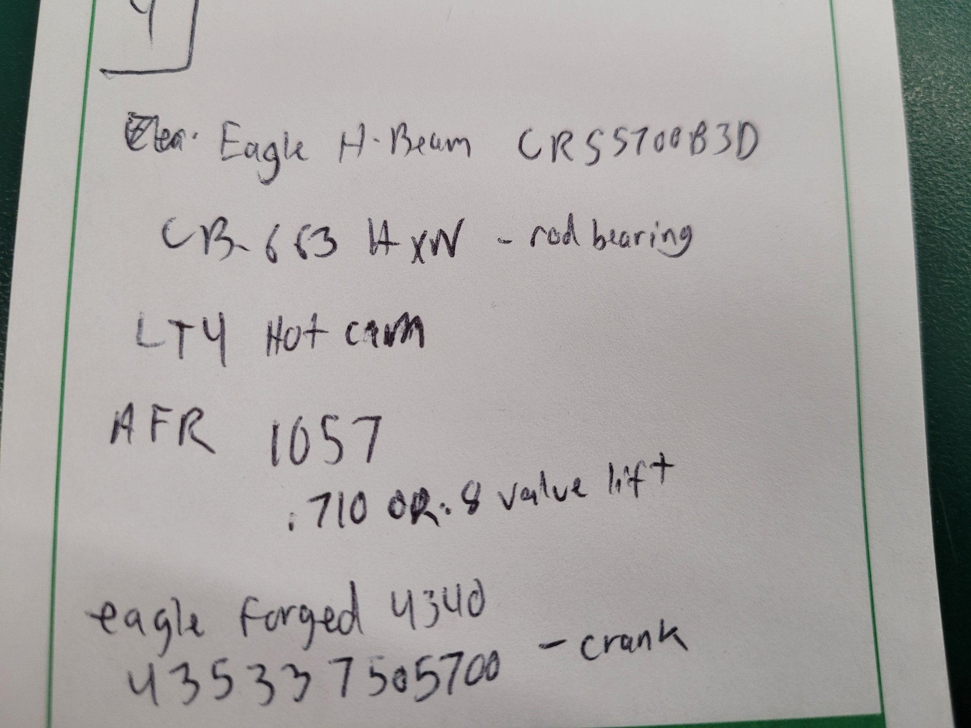

Trying to price out a build while ignoring the rotating assemblies. Will this work together? And tryin to figure out piston to match if it does. And whether to do .710 or .800 valve lift for heads

Long tube headers, cam + springs, and some port work on the factory heads is all you need to do what you want. I'd focus on keeping the engine mods easy so you have more time for the seemingly never ceasing yet inevitable engine swap setbacks.

issue is whole engine needs rebuilt been sitting and had spun bearings, cracked head. So if imma replace it, might as well upgrade it
