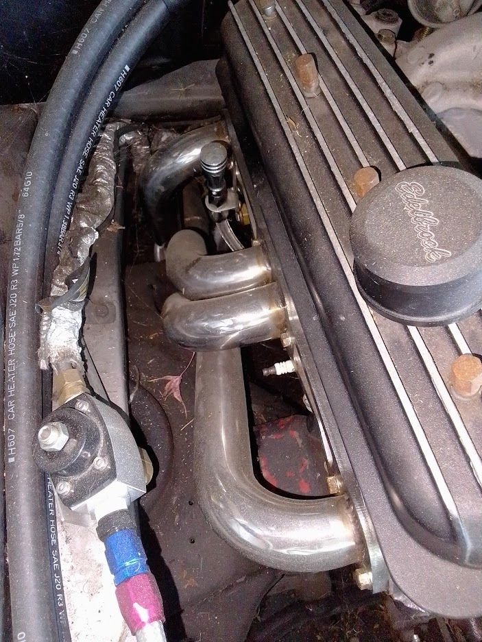

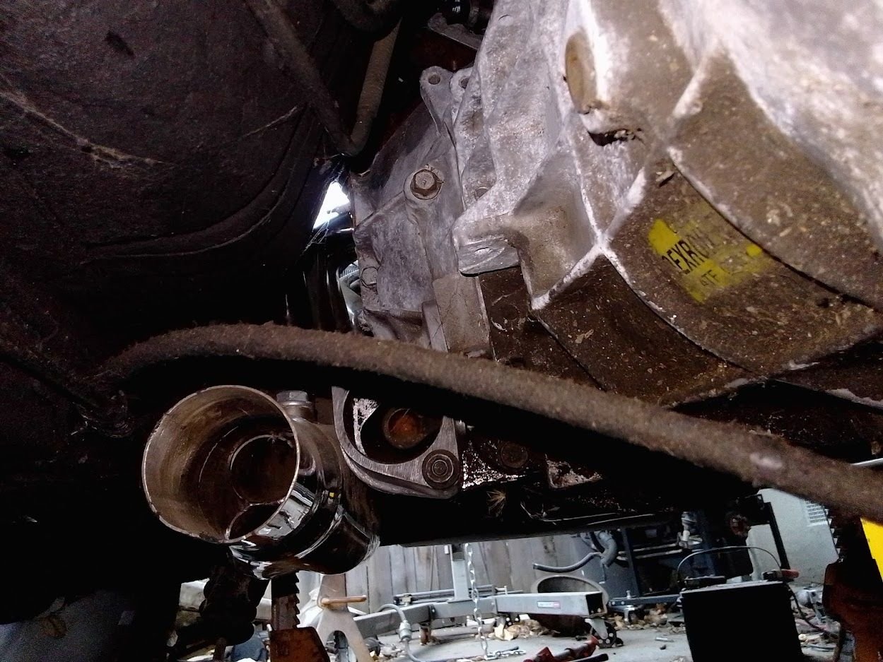

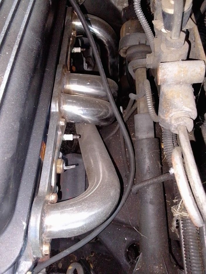

Sorry for the late reply. I did have to ding a few spots for clearance but the fitment is great with the 1993 LT1
t56. Sadly I haven't finished my project but I think I have a couple of pic buried that I will try to dig up
I have advanced heart failure and it's hard to climb under the car.
Ground clearance is excellent.
Plenty of clearance from the DS header to the slave cylinder.
Tons of clearance to the steering shaft.
Zero issues with the PS header.
Vortec head spark plug clearance was good but I dimpled 1 tube to get a 1/4" clearance. If I bought a shorty plug it would have been fine.
