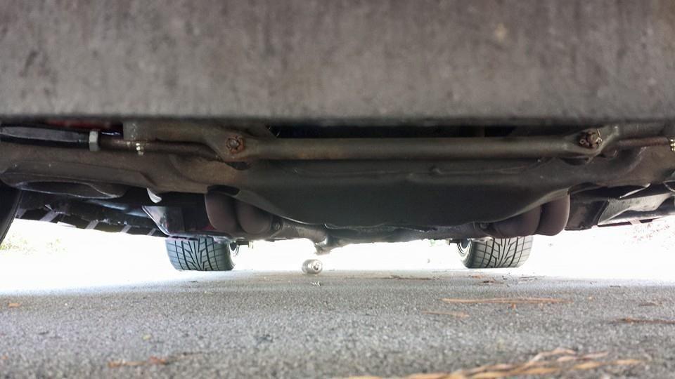

My hedmans are pretty painless. They tuck up well if you've got a lowered car too.
One Primary got dented in a tad, teh a arm perch got trimmed... otherwise... that's about it.

That's the best ground clearance I've seen on long tubes. ^

these headers two posts above me in the pic are they the hedman 68460?

Yes they are the 68460. Any clearance problems you have are going to be from getting the exhaust under the transmission crossmember. Anything you do to address that will solve it.
