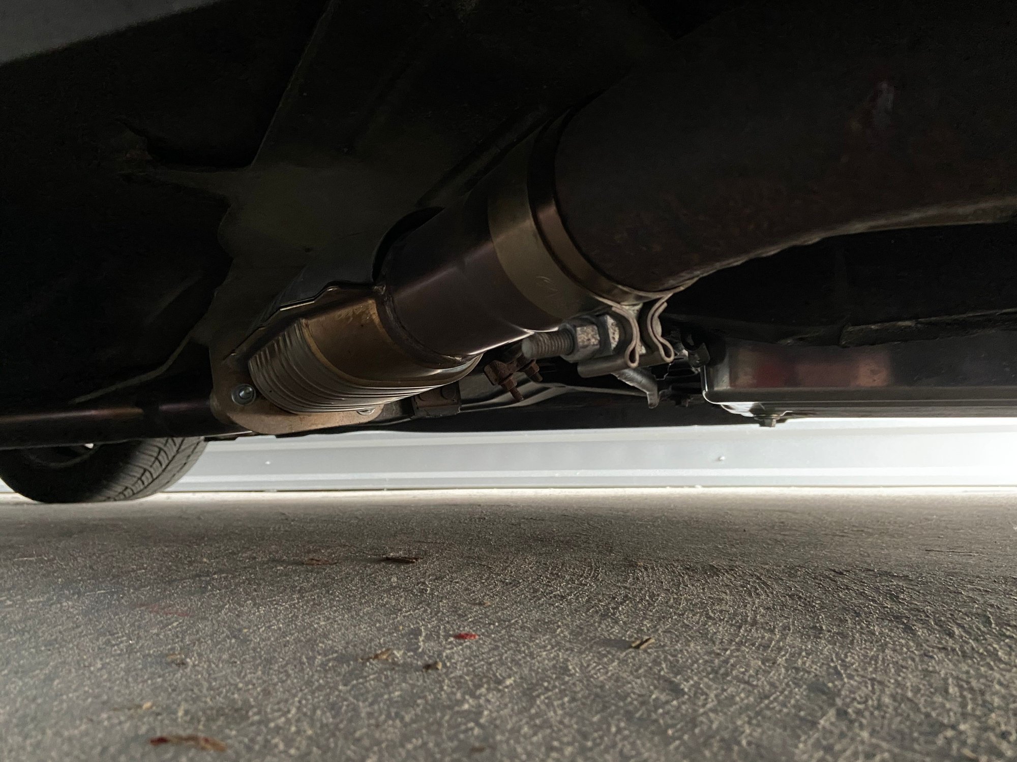

Just wanted to throw this out there and see if anyone has installed SFCs with a similar exhaust set up to mine, which is factory manifolds going soon to Magnaflow 16450 y pipe to a already installed Magnaflow direct fit cat and Magnaflow 3in cat back. I like the UMI 2400 and looks like a quality piece but just want to see if anyone else has tried this and what the results were?? The likely trouble spot is the additional brace on the passenger side getting clearance for the cat. I don't have the UMI SFC yet so if anyone else has a good suggestion for that set up I'm all ears.

I'm also going to be adding new headers and Y-pipe in hopes of making it clear the SFC better. If you can post a pic of your exhaust I may be able to tell you if the third piece will fit.

Old Mar 16, 2020 | 05:20 PM

Re: Magnaflow 16450 y pipe and UMI SFC clearance?
Kinda hard to get good pics in storage but let me know what you think, thanks again.

Looks like you have alot more clearance than I do. The driver side connector is no problem - you might have to use a c clamp to press out any heavy dents to give you a flat welding surface. The passenger side should fit fine but the third piece will be questionable - however it looks like you have plenty of room for it, though you'll still probably want to unbolt the front of the exhaust to install it.
Feel free to hit me up if you do get them and have any questions. Overall its not bad, but I advise running some practice beads on scrap metal joining 3/16" to 1/16" to get your technique and welder set right...My welders recommended settings were too hot and I burned through a few spots before turning it way down.

Sounds like it will work, I sent those pics to UMI and hope to hear the same from them. I’m thinking just replace the y pipe at the same time as the SFC install, should make it easier. Also I did ask UMI about the importance of the third piece and he said you could not add it but it does have significance...
