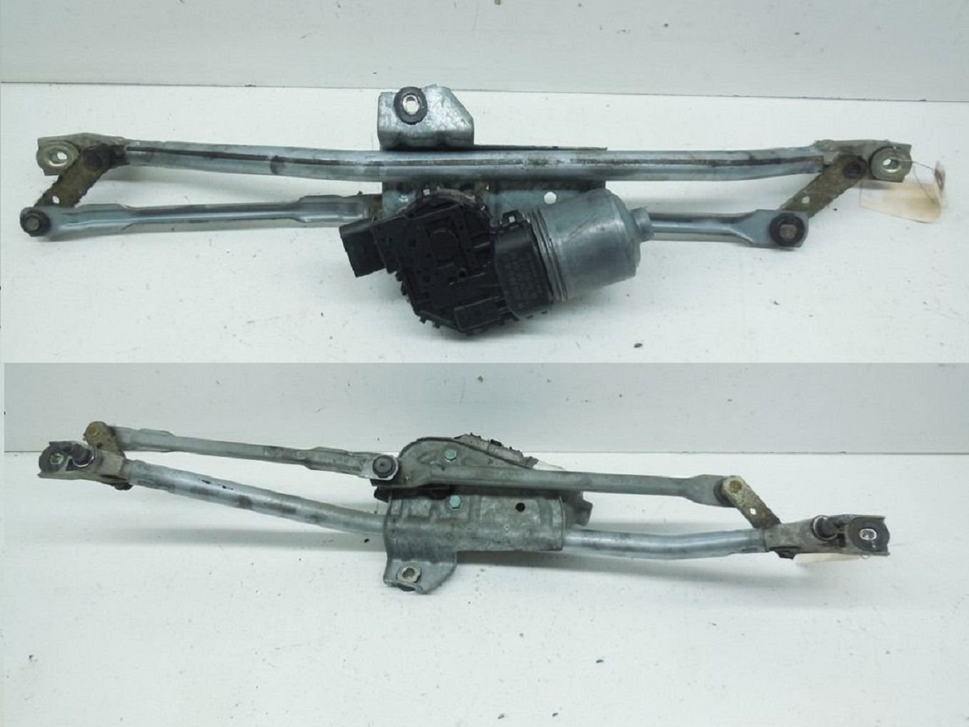

Ive read (here) the later s10 motor also works.The 98-up passat looks alot like the current 5th gen camaro set-up.I would guess you need a wiper motor w/ at least as many wires to connnect to, since the 3rd gen w/delay has six (cover), plus the 3 on the motor end.Some of those are duplicate as they go to the cover, but other brands only have 2-3 wires.The s10 uses five.At least one on the 3rd gen is a ground.
passat
camaro
