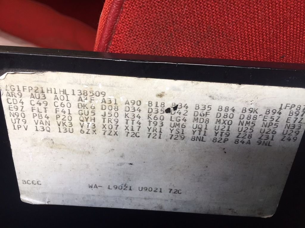

Been inquiring about this car for some time now. I took a look at the RPO codes and can’t figure out if it’s a true IROC. It’s got the Z28 Code but no B4Z. It’s an 87.

For 1987, it should have the B4Z code if it's an IROC on top of the Z28 code. This changed in 1988 where the B4Z code was no longer used and just Z28 was used.
So, no, based on the RPO sticker this car is not an IROC.

sorry forget that don't see 16" wheel size any place so no not an iroc-z

As has been mentioned, NOT an IROC. Could be a cool car. At least it has a 3.23 gear. Just don't pay IROC money for it.
