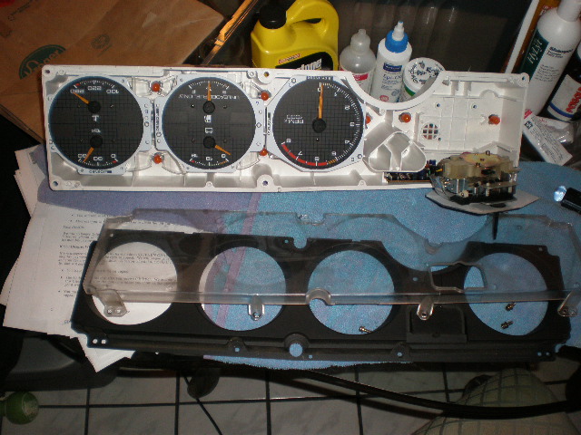

Does the speedometer needle itself work, but the odometer #s won't move?
If so....That is what happened to mine. One of the drive gears in the back of the speedometer broke a tooth off & the #s just stopped rolling.
I swapped out the ENTIRE gauge cluster, because it was just easier. I have a guy I talked to about making some new ones out of aluminum or steel....Whatever we decided on, but I decided they weren't needed to enough to justify having a batch made & having just ONE, was too high $$ to justify making.
Now that I have the old gauge cluster out, it would merely take me pulling it out & having them made. I wasn't gonna run around with no gauges, while it was being made. And since I have a new cluster, it's no longer a priority for me.
The gear that broke (a single btooth broke off) my arrow is pointing to, is the real light beige one, just maybe 1/8" from the tip of the arrow.

Re: Speedometer
Regardless of digital or mechanical speedo, there will be a cable from the tranny. It goes up into the dash, gets converted to an electronic signal, then is either displays digitally or turns on an electric motor that move the speedometer gauge.
Here's my "mechanical" gauges, but the signals are converted the the electric motor turns the needle of EVERY gauge.
Attached Thumbnails Speedometer-87-gta-gauges-2   Speedometer-87-gta-gauges.jpg

Yeah the second pic is that the back of my cluster looks like. so the cable that goes from the tranny, through the firewall and into the dash is the speedo-cable?
Old Aug 2, 2008 | 06:36 PM
Stephen's Avatar
iTrader: (12)
Posts: 12,212
Likes: 13
Car: 87 GTA
Engine: L98
Re: Speedometer
Both pics are of the same gauge cluster.
