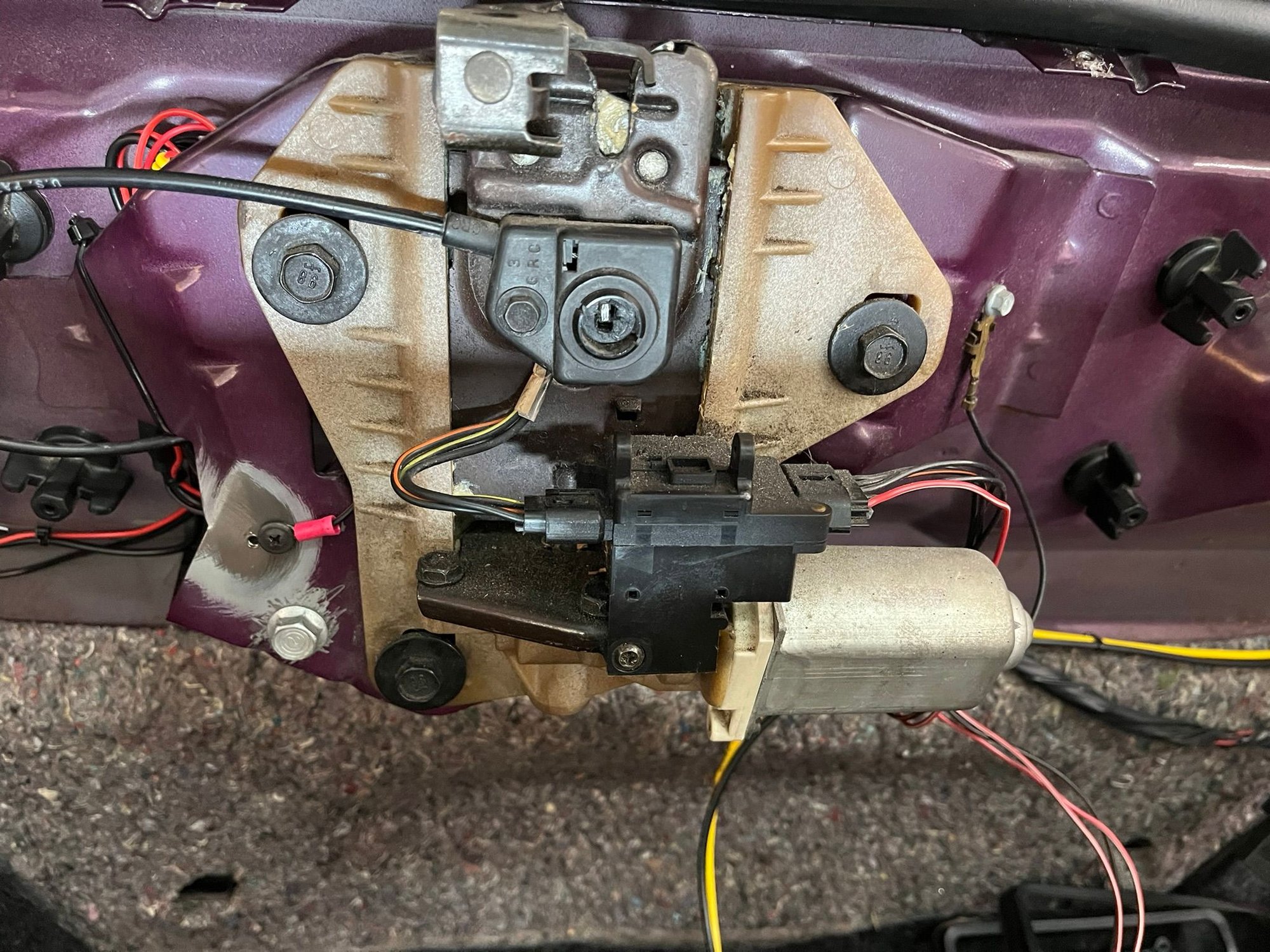

HI all, I am looking to install an electric hatch relese in my 92 RS. I have been looking all over the place for the pull down motor with the relese. Am I missing somthing? I see all kinds of the older model with a release. Is there a seperate solonoid for this?

The late 91-92 hatch pull-down units don't have a electric solenoid hatch release. They can have an optional hatch release button, but it functions to start the up cycle of the hatch pull-down unit. As the unit powers up and reaches near the end of the up cycle there is a lever on the back of the unit that contacts a ramp causing it to rotate and release the hatch hook. At that point there is a spring that pops the hatch hook free of the hatch pull-down unit.

Well, I found the wiring, it was already there. It is not hot though. Is there a relay or somthing that is used for the hatch relese?

check your fuse box to make sure theres a fuse in it. someone may have pulled it out for some reason or it could be blowed

The solution was, there is a relay under the center console(mine was not installed). It's hooked to the switch wiring.

I'm in the same hole. I have a 92 Firebird that has the wiring for the hatch release behind the bezel just above the radio. I purchased a bezel that includes the hatch release and it plugs right in. However, no go with simple plug and play.
3wheelnuts speaks of a relay under the center console, can anybody elaborate?

I don'thave a service manual, but in my car, I found the socket for the relay in the center console. I put the relay in, and it worked. I just needed the ramp for it to unlatch.

sorry to revive this topic.. but its only been a few months.. and i've read all the way through the thread.
I have a 92, it has the power pull down hatch, and ive added the power release button to the center console, and plugged in the two wires that were in the harness to it. The harness is out of a 91-92 Z28 camaro, as i just re-wired the entire interior of the car with this dash harness i had bought from hawks. From what i can gather, from this thread, since my hatch release button will not function, i need to plug in a relay somewhere. The question i have is where is this Relay located at??? I've tried to go to that site you linked above Lon to buy the manual for the car, but its a dead link. Any help is appreciated regarding this.
I realize my hatch system is the rare one that was used only for a half a year. see below :
from what i've read in this thread i do not need anything added to this here to get the switch functioning, however i may need a Ramp installed depending if it releases or not when it comes up. from being Popped. My goal is to have the factory trunk popper working as it should from the switch when i use it.
I do have one other issue. When i turn the key in the trunk key lock cylinder, i have to turn it all the way to the right till its like 90* over, and then when it is there it finally gets hard to turn and unlock the hatch. i almost worry that im about to brake the key off as hard as i have to turn the key to get it to unlock the hatch. any ideas? Thanks again yall.
