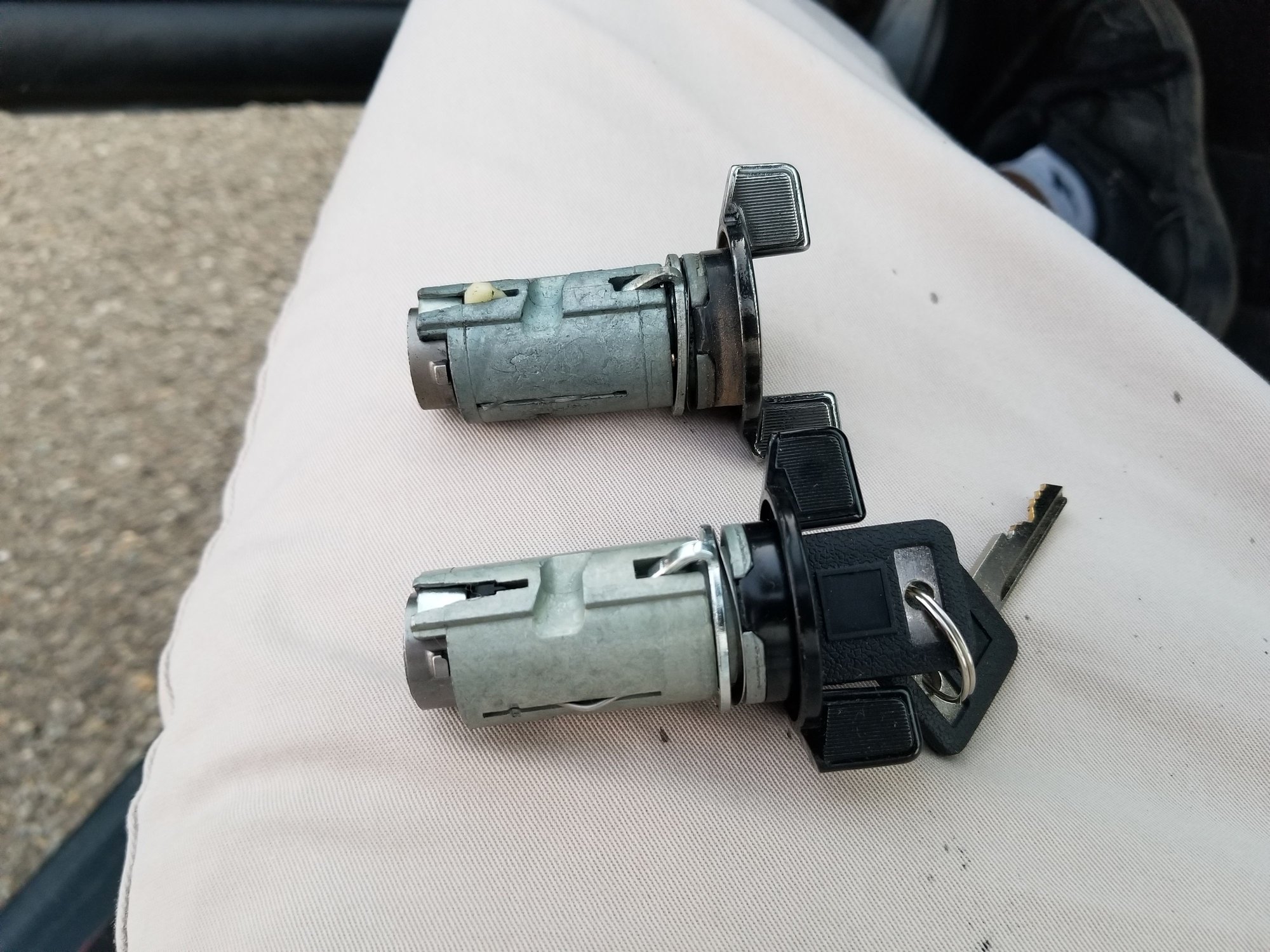

Same issue here. Just tried to turn on my Camaro. Been having trouble starting (possible bad ignition switch). So I went out to turn it on. No crank. As I turned the key back to remove it, the lock cylinder would not turn back to the off position. Luckily my key is so worn that I pulled out the key and disconnected the battery. So tomorrow, I'm off to buy a new ignition switch and a new key cylinder.
Old Apr 25, 2020 | 12:09 AM
Chevy86 IROC-Z's Avatar
iTrader: (17)
Joined: May 2009
Posts: 4,915
Likes: 41
From: Far West
Car: 1986 Camaro Z28 IROC-Z
Engine: 350 Tuned Port Injection, for now.
Axle/Gears: Posi - 3.23
Re: IGNITION KEY STUCK IN "ON" POSITION
Fixed my issue. Ended up being a bad ignition cylinder. swapped out for a new one and now it's good to go.
Broken inner collar.
