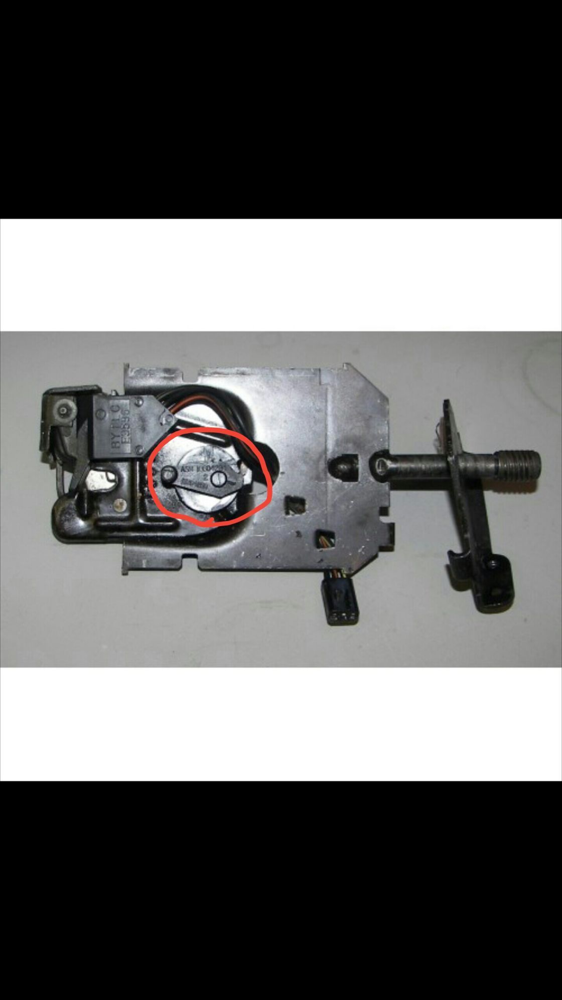

The lever was indeed mising from mine. BUT I was messing around with the new assembly I got from you lonsal and the level popped off and the spring too. I still have both the lever and spring (got lucky) but I don't know how the spring goes back on.

i got it! ok so the hatch release button lifts the hatch and at the top releases the latch...so that's all good now.
But when the hatch is all the way closed, my key won't release the latch?
Old May 23, 2016 | 09:48 PM
santiclause's Avatar
Joined: May 2016
Posts: 82
Car: 1992 Camaro RS T-Tops
Engine: 305 V8 5.0L
Transmission: 4LE60 Automatic
Re: NEED HELP trunk wont open 1992 camaro
Also, does anyone sell just this circled part. It looks like that little lever must have popped off on my old hatch assembly, I found the spring that goes behind the lever, but never found the lever.
