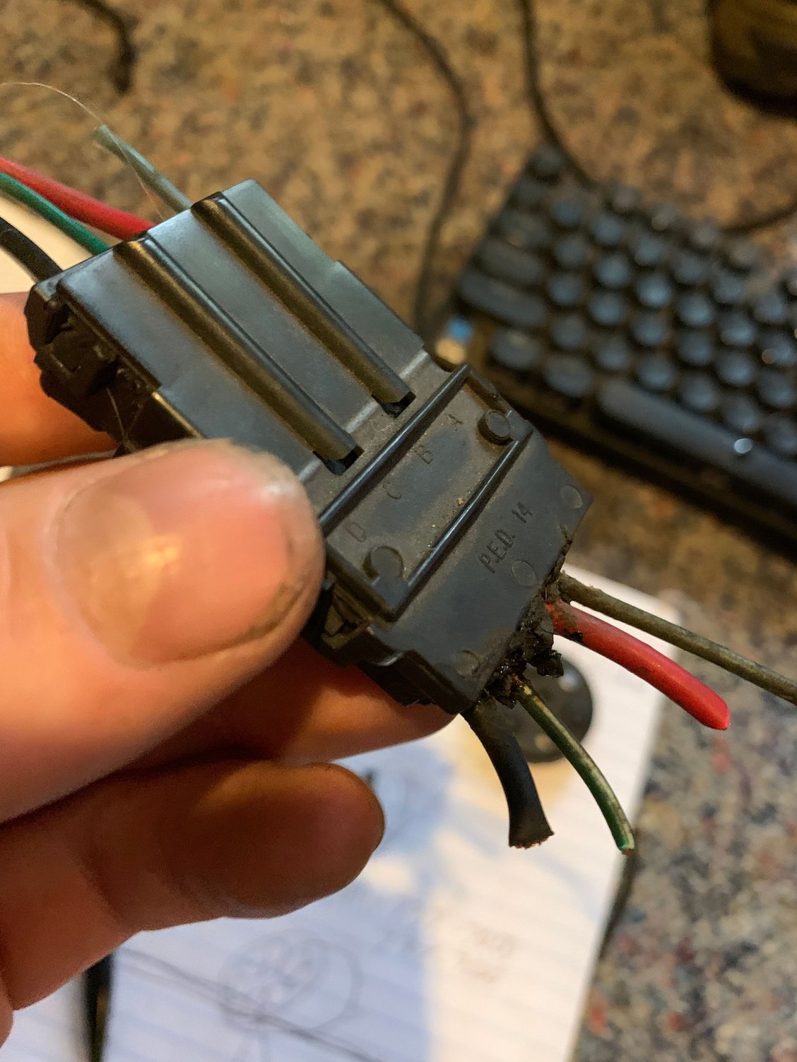

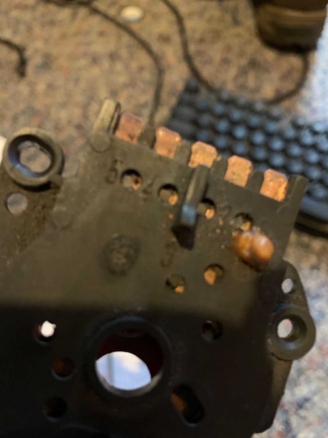

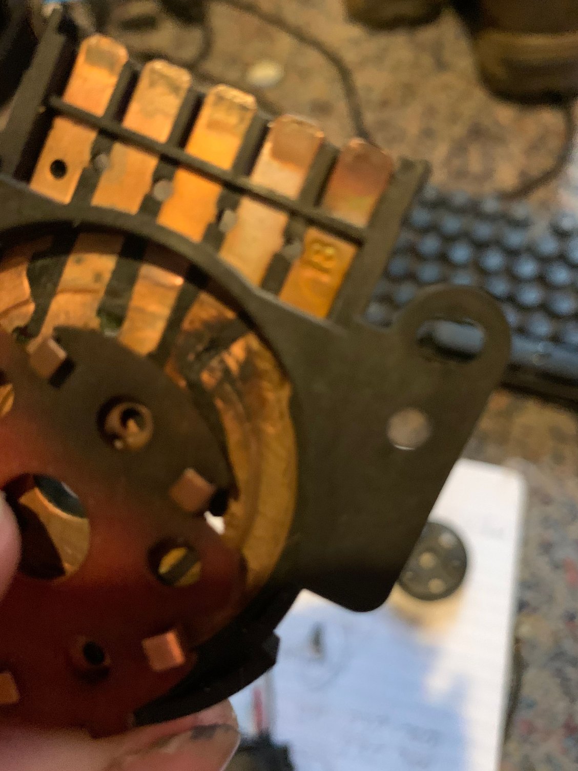

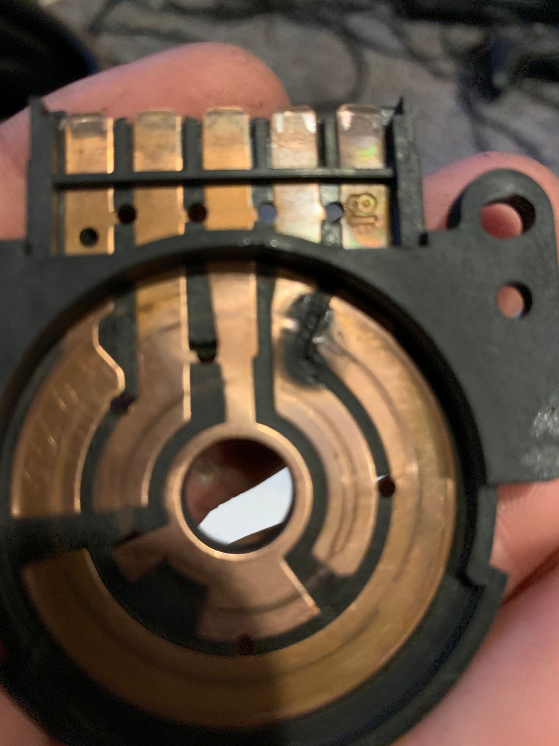

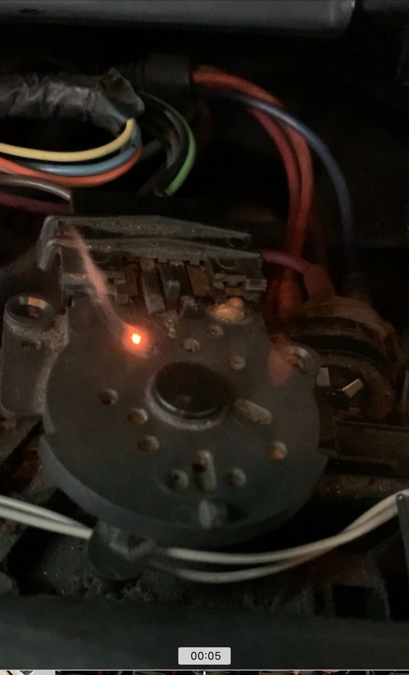

Hey folks, I landed my dream car 8 months ago. 91 firebird convertible and have done a fair amount of work to it. The hvac heater switch literally glows orange and melted between pins 4 and 5 , but everything works. Also noticed a melted connector under the hood that controls the cooling fan and blower. I did replace it carefully.. I can’t for the life of me find that 5 pin rotary switch or even a part number anywhere. Anyone have an issue like this? And for the love of god, anyone know where to get one??

Jesus christ, its arcing. Talk about a fire hazard! Good thing you caught it. Kinda looks like you stopped the selector between two terminals causing a power surge/short, maybe. Used is probably your best best. There's still some nice ones around. No repros that i know of. I think the link above is for the blower fan speed.

This is common. Pin #5 carries current for the Medium High (position 3) fan speed and it is undersized for the current. Mine looked way worse than yours and I was able to recondition it and have been using it for the last 6 years. Also got a spare from a junkyard just to have on hand. Basically never use fan position 3 to avoid this again in the future.

You guys are really cool cats around here for the help, I did buy one of those but when I saw pin 4 and 5 are hanged together I thought it was the wrong one. Even the gm site shows one with 4 then 5, same part number. I probably did this, in the summer I was using the max setting to keep the cooling fan on in traffic or the city. I do have two climate control heads coming, one today, one switch via eBay, the electrical connections under the dash look fine. My blower itself was toasted, bearings make a shitload of noise too. I’ll let you know if there is a shirt somewhere or if all is well after, in better news, I did find my pesky vacuum leak while I was in there! Silly diaphragm switches to be honest.
