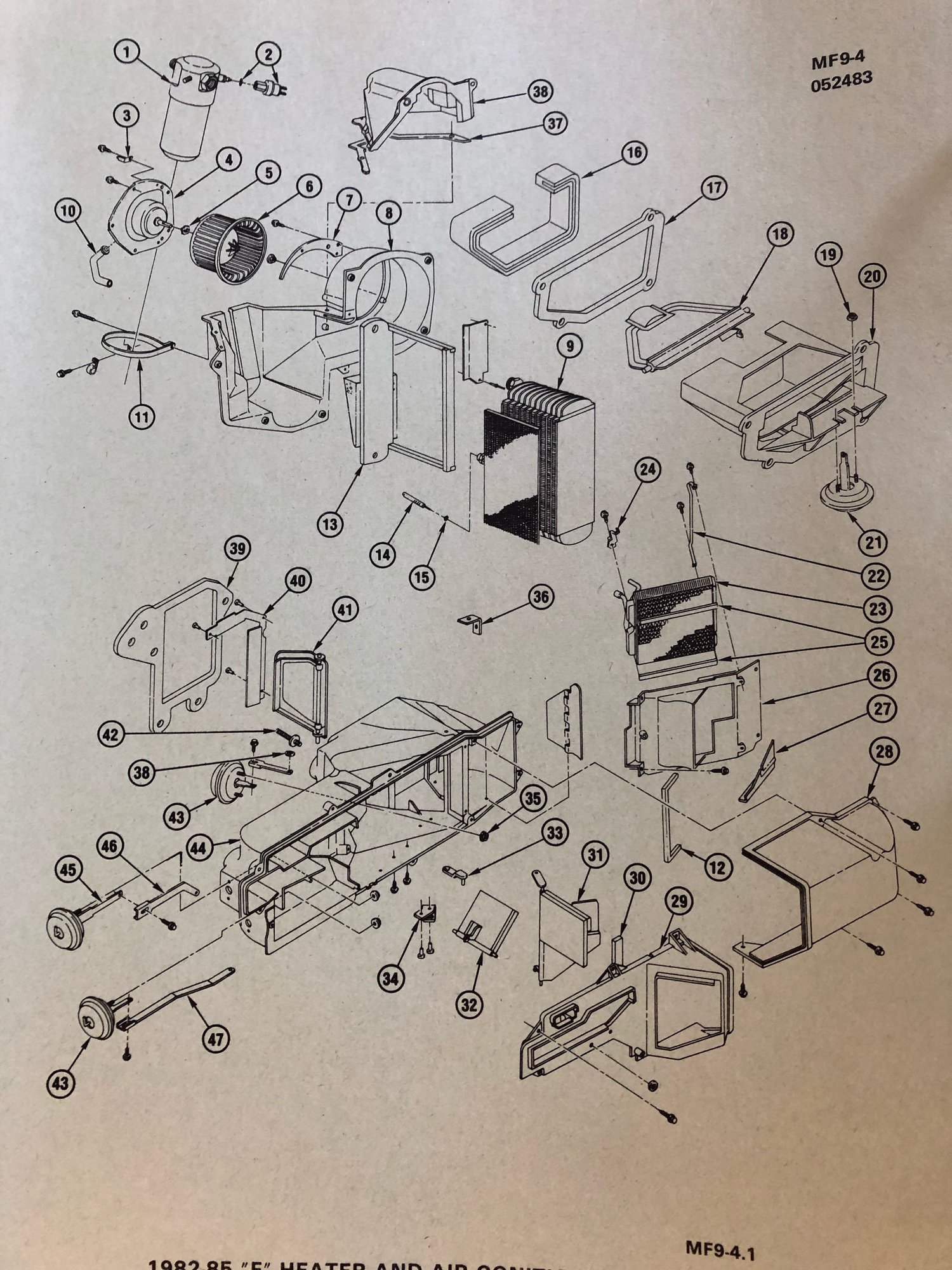

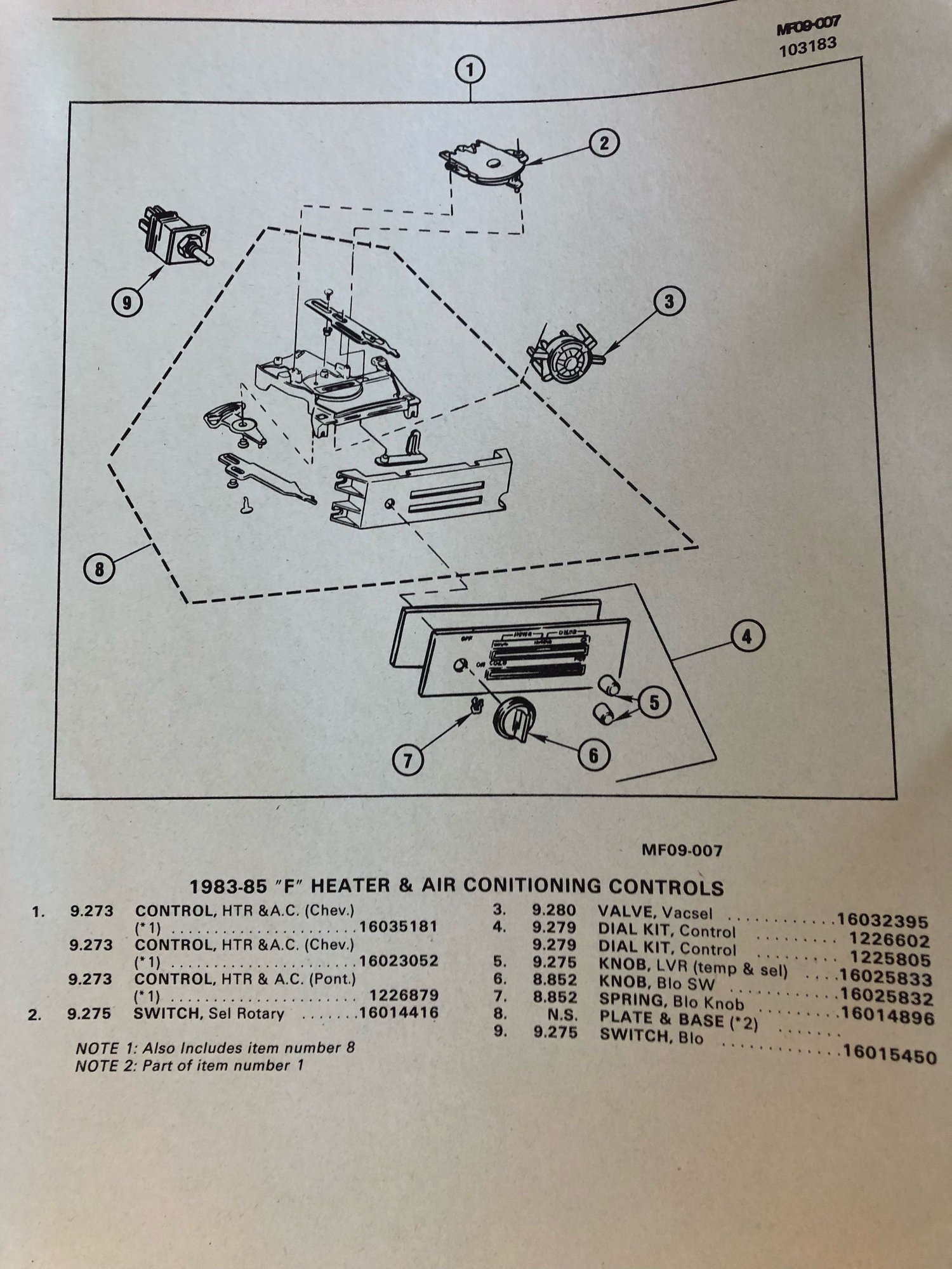

Perhaps something below will be of help.
JamesC
