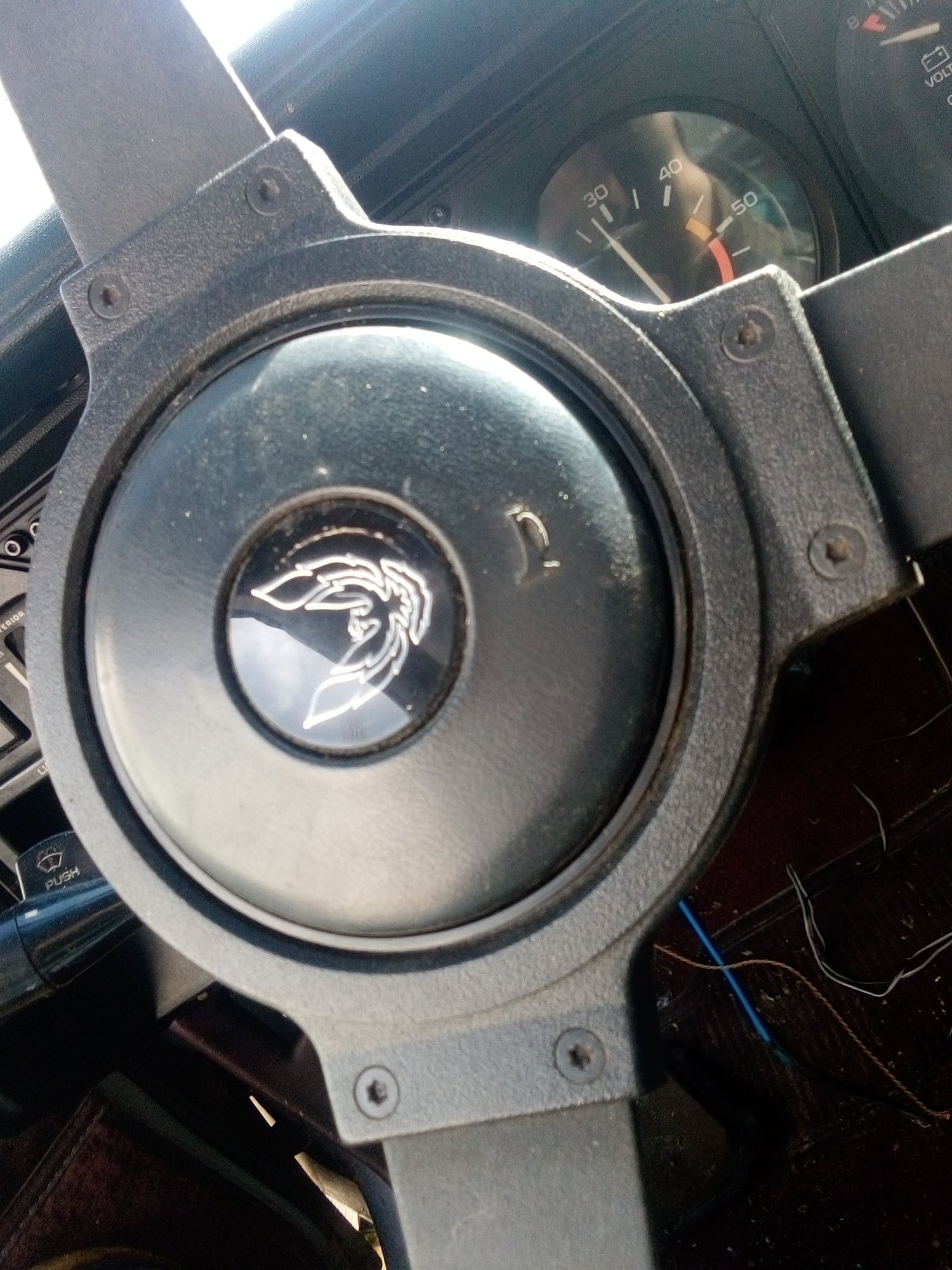

Here's pic of horn pad.
1982 Firebird horn pad.

Those screws are fake, and not holding anything. Pop the horn pad out with a flat-blade screwdriver..

Exactly what I needed to know! Thanks so much ! Awesome site for us 3rd Genners!!!
