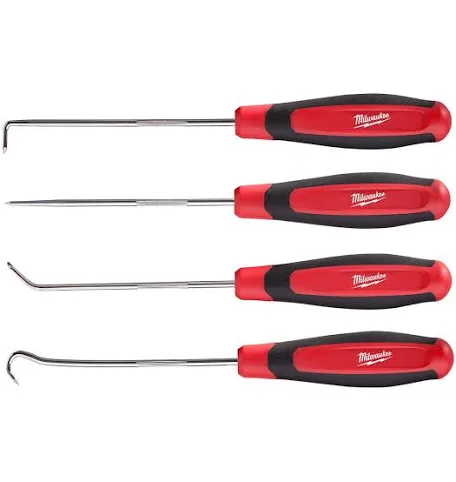

I got mine out with a set of small pic’s from either Matco or Mac tools. Picture below of similar set from Home Depot.
From Home Depot
From Home Depot
