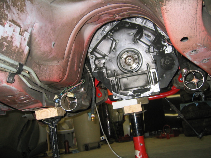

I have to chime in here... I got in on the headers and ORY before the price hike. Glad I did. HOWEVER... Im NOT glad that I spent the extra $300 for the ORY. That thing is pure junk. First of all..it has O2 bungs. Why the heck would I need O2 bungs on an ORY with no cats??? Should be an option...OR include some stainless plugs to put in the bungs. Now I have to figure out how to plug them.
Second...Dont get me started on how the y-pipe fits. Or doesnt fit.
Third... The y-pipe is ugly! Where the two pipes join together, if you look in the 3" end, the opening created by the two pieces coming together is more like 2" !!!
Now I have to cut the weld for the 3" part, cut all the access tubing out that doesnt need to be in there, and weld the 3" piece back together.
Fourth... The O2 bungs on the headers themselves werent TOO bad. The driverside O2 hit the body of the car. I thought that was stupid. I had to bang a friggin dent in my floor board, to make room for a sensor that could have been welded a few degrees differently. The passenger side seems ok though. Thats after I had to clean up the threads because there was weld blocking the O2 hole. Couldnt get the sensor in. Good thing I didnt just force it or the sensor would have been toast.
When they welded the bungs in...it seems like the heat warped the ends of the tubing. Making it a PITA to get the pieces together. Small issue I know...but for the price I think they could have atleast formed the ends back to round for us. Makes me extra ticked because I dont even need those stinking bungs in the y-pipe.
The # 3 spark plug boot is jammed up against the primary...but thats not a biggie. The solution was sleeves or boot trimmin. I think Ive seen that problem on other headers too...
Here are some pics for the heck of it. I should take one of the y-pipe opening.. All said, I think $700 for the headers isnt bad. But I regret the ORY...and I might just ditch it and make my own. Or cut these up and re-work them how I want.
On a positive... in the pics you can see I have a generous amount of room on the sides of the collectors. I say generous because ive heard so many others say they are extremely tight.
Please dont take this as me bashing hawks or stainless works. I talked to Bruce several times about other things, and he is great to deal with. Im just alittle disappointed in this set up. Its been around long enough that the bugs should be ironed out...and these should be the best choice for anyone doing the swap. I just wanted to vent a bit... because I was hoping the exhaust portion of this wouldnt be such a pain. But it looks like thats going to the be the hardest part of this swap by far.

Now I have to cut the weld for the 3" part, cut all the access tubing out that doesnt need to be in there, and weld the 3" piece back together. Fourth... The O2 bungs on the headers themselves werent TOO bad. The driverside O2 hit the body of the car. I thought that was stupid. I had to bang a friggin dent in my floor board, to make room for a sensor that could have been welded a few degrees differently. The passenger side seems ok though. Thats after I had to clean up the threads because there was weld blocking the O2 hole. Couldnt get the sensor in. Good thing I didnt just force it or the sensor would have been toast.
