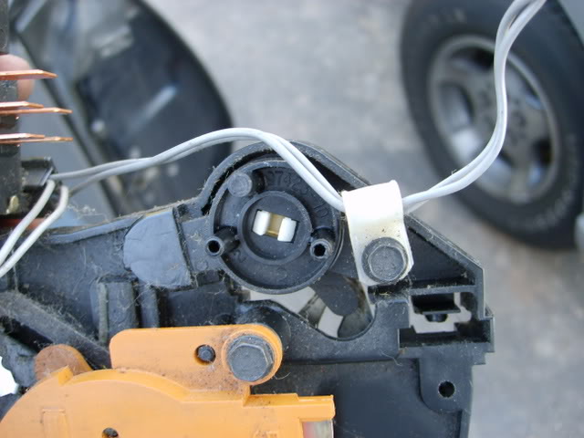

Whats up everyone. I decided to finally install a heater control valve in my car. Ive been suspecting that not having the valve was causing my a/c to not work efficiently.
My 87 came with a valve, but my 86 didnt. I put the HVAC controls and associated harness/hoses from my 87 into m 86, with the idea that Ide install a valve some day.
The LS1 circulates coolant through the heater core all the time. They dont have heater control valves. I never found a clear cut answer about the LS1 heater hose outputs on the water pump. Some say you can just block the flow off from them, some say the coolant has to circulate. SO I needed to find a valve that would allow that to happen. This is what I came up with.

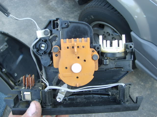

When the temp slider is over on the hot side, the vac line going to the heater control valve is dead. No vac. The coolant flows through the valve like it wasnt there. When the slider moves over to the cold side, vacuum is applied to the line, and the valve switches so that coolant goes in and comes out on the same side. The heater core side just sort of stops. Some coolant will still squeak by, but the majority will not. I felt the hoses, and the hoses after the valve do cool down compared to before...so its working. That cools down the heater core, thus cooling down the HVAC box area, thus making the air cooler as it goes through.
It seems to work. I topped off my system with a can of 134, and now it blows very VERY cold. Just like it did in the 4th gen donor car before I took it apart. Im going to try it tomorrow on my drive home from work since it'll be hot.

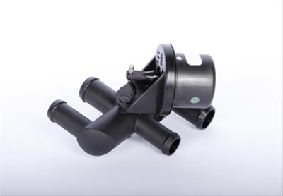

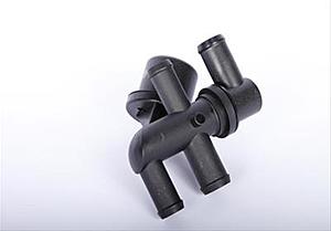

Just an FYI to those of you looking for a good option. The valve is from a newer full sized chevy van...but all you need is the part numbers I gave you. It fits really good.

Thats it... not a big deal, but I dont remember seeing a heater control valve solution detailed anywhere.

So here are some pictures to maybe shed some light on things.
Here are the stock 86 controls.
Here are the 87 controls. Notice the extra piece in the upper left hand corner of the unit. This is the "switch" for the heater control valve.
The units are otherwise identical.
I THINK...not positive...that the purple hose is the vac feed for the system. In other words, you hook the hard line to the intake, and that is where the purple hose gets its vac. Then...on the heater control units, the purple hose is t'd off to go to the vac switch. On the other side of the switch, is the grey hose. That hose is dead when the temp is set to hot. When you switch to cold, vac goes from the system feed hose (purple) to the grey hose...which in turn goes out to the valve.
The other end of the purple/grey hoses coming off that vac switch.

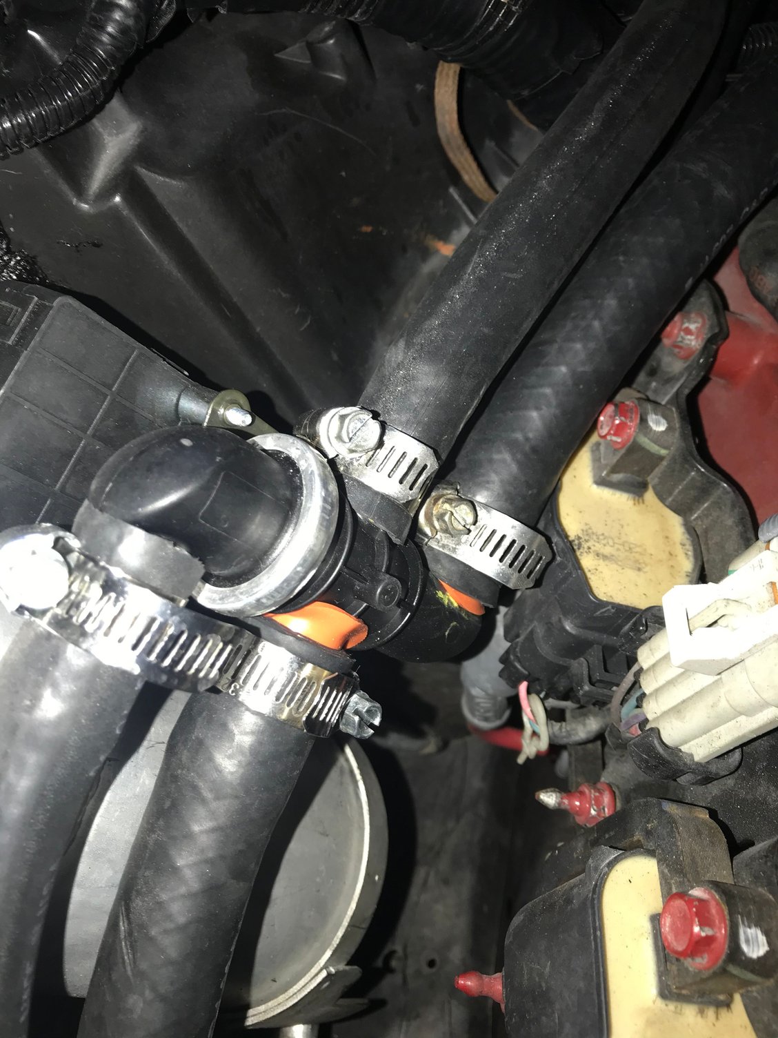

Thought I would add in some hose part numbers since I went out today to start this swap.
I bought two hoses at Advance Auto parts (Part #80405CS). I did have to trim 2" off the 'short' side to tuck them in where I wanted them. I will post pics once the car is more together. Right now its in 'mock up' stage.
Hope that helps others do this swap!

ok, grabbed another hose that is the correct size for the larger fitting
80416cs
pics to follow once I trim everything down to size.

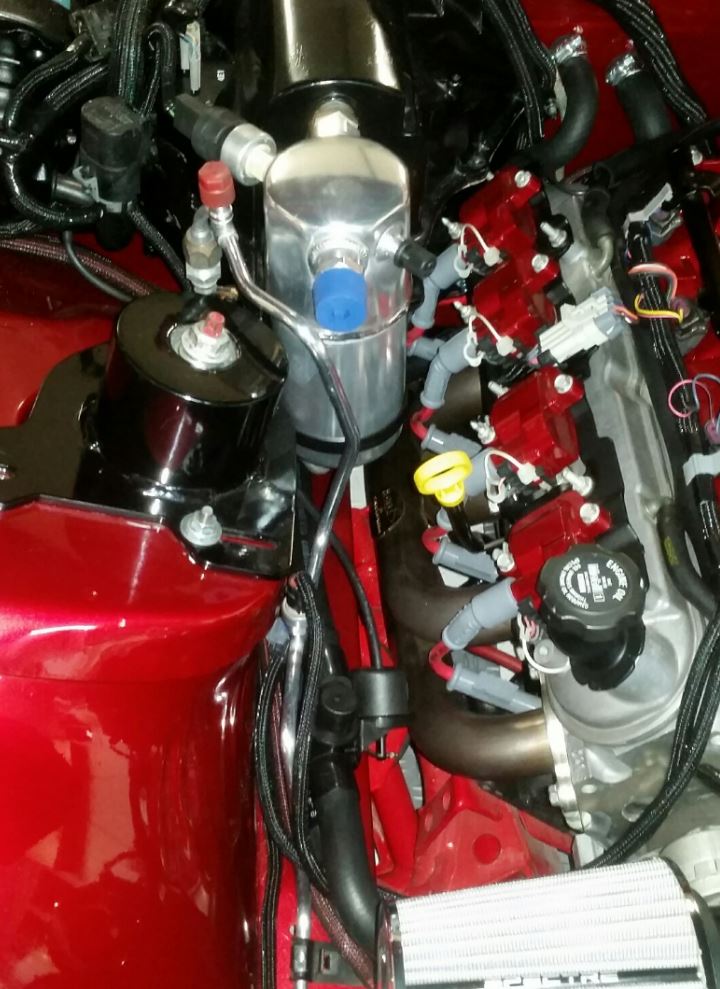

Ok, got my install wrapped up and am a lot happier with it......
Attached Thumbnails Heater control valve for LS swap.  Part number and pics.-heaterhoses.jpg   Heater control valve for LS swap.  Part number and pics.-heaterhoses1.jpg   Heater control valve for LS swap.  Part number and pics.-heaterhoses2.jpg

Not a bad idea to have 90's coming off the valve. My 90* ends are up at the heater core, and it still seemed to flow pretty well by just putting the valve right in the middle of them.
Now that Im working at autozone again...Im going to root through the hose isle when its time to redo things, assuming Im still working there for extra cash. That is...if I dont ditch my A/C. If I do, I wont need the heater control valve anymore and will probably ditch it and run hardlines from the heater core to the pump.
Looks good Jay!

I bought two of each hose.
Then trimmed them to fit the way I wanted.
I used the 90's off the heater core to get the valve on the strut tower
Then used the 90's to get down to the water pump (obviously).
I am really happy with how it turned out and it works great... got the car running today.

ghettocruiser, thanks for the tip. I got the valve installed and it seems to work good. I've only had the car running for about 15 minutes, but the valve worked as expected when I moved the HVAC control to Cold.
For vacuum i ran the factory hard line through the HVAC wiring harness and had it exit near the Fan Relaly. Then i ran a piece of vacuum hose from the line to the valve.
For the heater hoses I used the factory V6 hoses on the firewall. I then used a male-male adapter to connect those hoses to some standard heater hose. From the valve i used a 90 degree hose to make the bend to the water pump.
Attached Thumbnails Heater control valve for LS swap.  Part number and pics.-20160325_215107_resized.jpg   Heater control valve for LS swap.  Part number and pics.-heatervalve.jpg

Hey nice install what kind of clamps are those on the heater valve they look nice?
Old Mar 27, 2016 | 08:10 AM
Camaro0605's Avatar
Joined: Aug 2004
Posts: 173
From: PA
Car: 1991 RS
Re: Heater control valve for LS swap. Part number and pics.
They're Gates Power grip clamps. They work like heat shrink tubing and can only be used once since they need to be cut off to remove.

I'm bringing this back from the dead.
I didn't see the part number listed anywhere in this post and most of the pictures won't show up.
I'm pretty sure the valve shown is GM 12380318 or (AC Delco 15-5533). I'm putting AC back on my LS GTA and going to try one. Very nice since its inline and I can simply splice it into my current hoses.
Attached Thumbnails Heater control valve for LS swap.  Part number and pics.-12380318-1.jpg   Heater control valve for LS swap.  Part number and pics.-12380318-2.jpg

The one I used was 74781 from a 2000 2500 Van.
