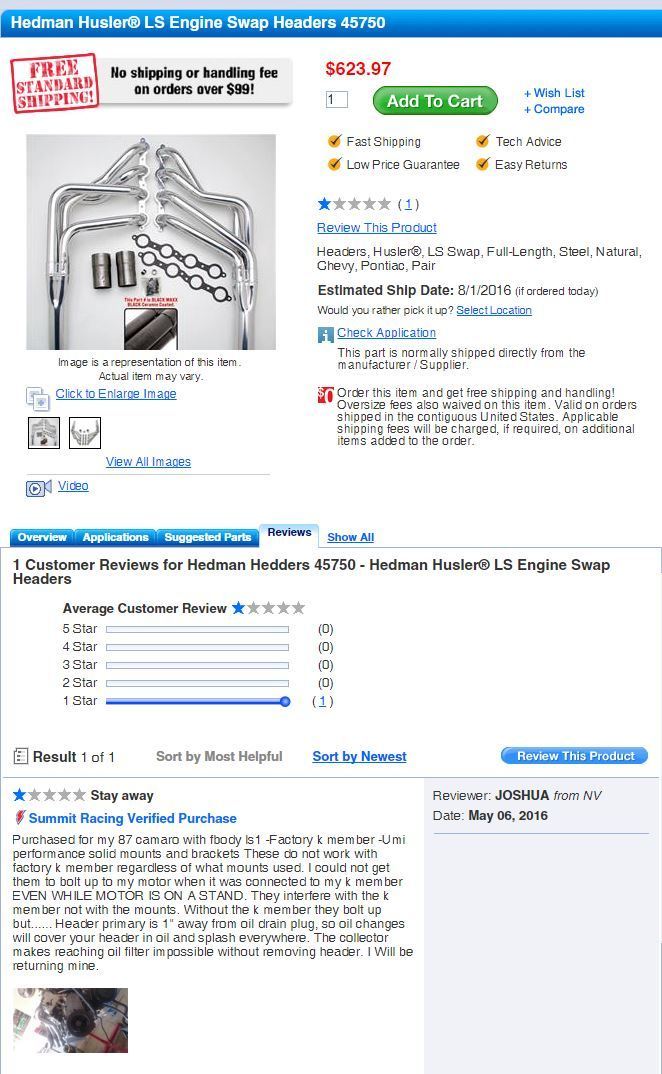

Hmm - I found this review on summitracing.com .
Purchased for my 87 camaro with fbody ls1 -Factory k member -Umi performance solid mounts and brackets These do not work with factory k member regardless of what mounts used. I could not get them to bolt up to my motor when it was connected to my k member EVEN WHILE MOTOR IS ON A STAND. They interfere with the k member not with the mounts. Without the k member they bolt up but...... Header primary is 1" away from oil drain plug, so oil changes will cover your header in oil and splash everywhere. The collector makes reaching oil filter impossible without removing header. I Will be returning mine.
I wonder if an oil filter relocation kit is necessary. The headers are supposed to be used with Hedman's LS engine mounts, and that probably solves the k-member interference issue.
Dang, I really liked how these looked. I have read though that the Mid-length headers are only slighly less powerful than the Long Tubes so you're not truly losing much.
