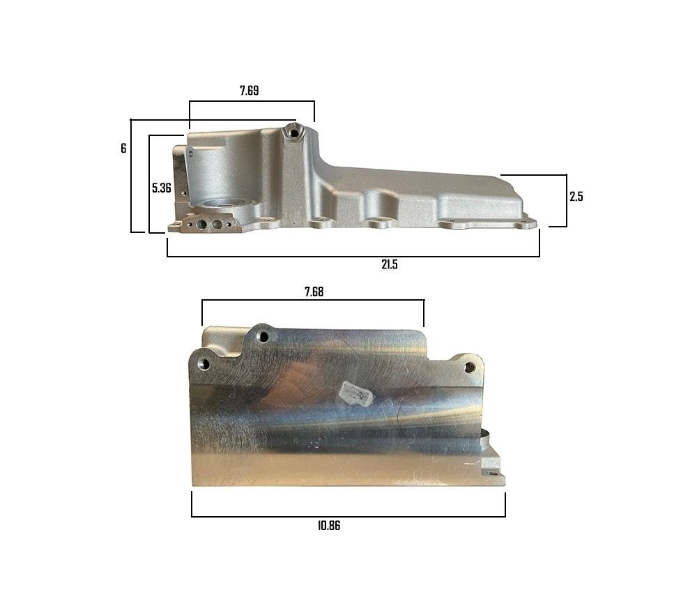

Just saw this new pan from Speed Engineering. The price of $250 is quite a bit cheaper than the standard F-body pan. Dimensioned drawings are below. Thoughts? I already have the F-body pan for ym project, so I won't be trying this. Looks like it includes everything but the dipstick.

Here is a dimensioned drawing of the Speed Engineering pan:
Here is a dimensioned drawing of the original GM F-body pan:

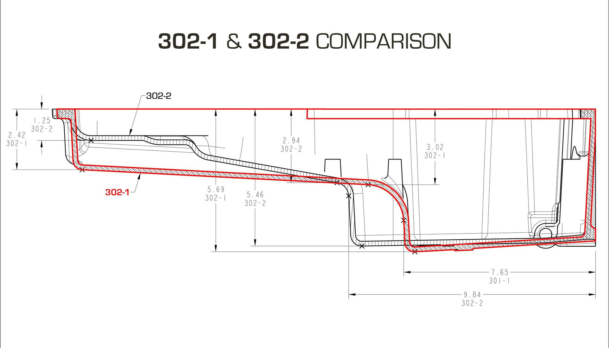

Here is a dimensioned shot for the Holley pans:

Not really cheaper than the aftermarket replacement f-body pans at all, this is possibly more than that.
It looks VERY similar to my JZ Motorworks pan. That pan should allow you to run a Y pipe exactly like the 3rd gen routing, between the pan and the crossmember.

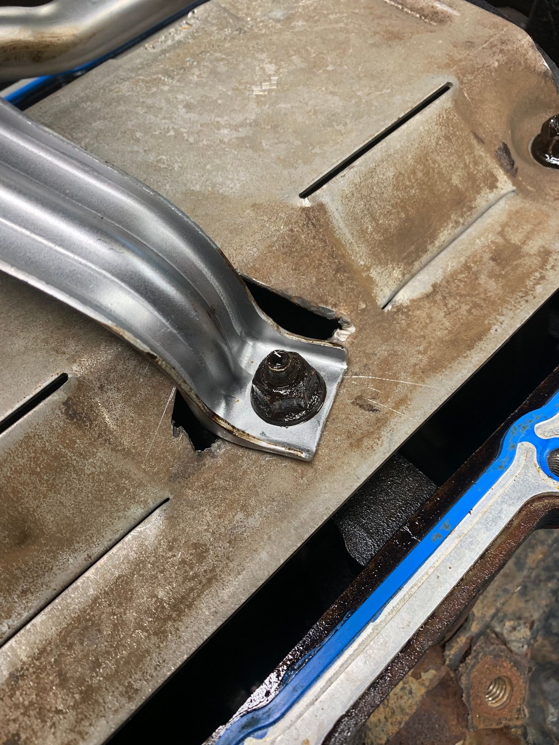

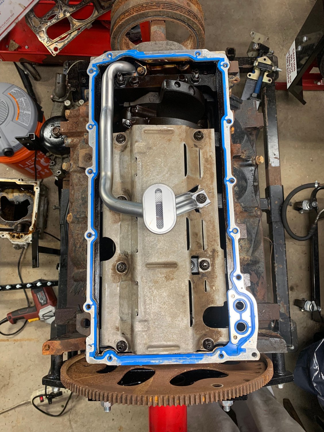

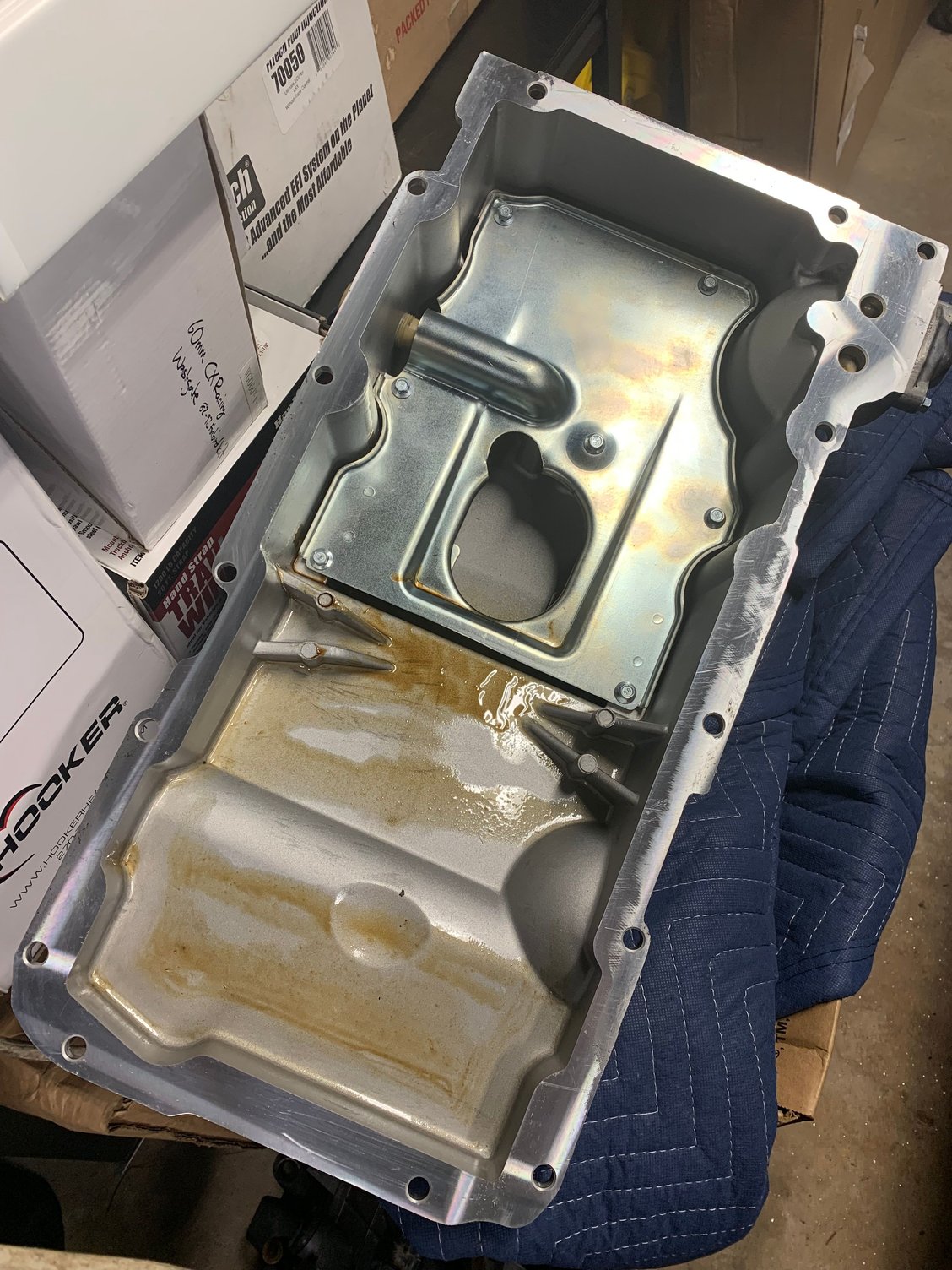

Here are some pics of the ebay pan that I run on one of my 5.3s. I also included picks of the cut stock truck windage tray. This is the now $95 ebay pan, new GM fbody pickup, spare oil level sensor and cut truck windage tray. As you can see the casting is VERY smooth inside and outside where my GM pan is very rough with casting flash... the inside you can't even try to wipe with a towel as its so rough and sharp it shreds the towel.

Wow, thanks for all the pictures. Looks like a nice pan!!.
I found a link and edited my previous post but you responded super fast!! Haha. I think I will go with one of these on my L99 (LS3 conversion). I think the L99 windage tray can be cut just like the truck. I will cross that bridge when I pull the stock pan off.
