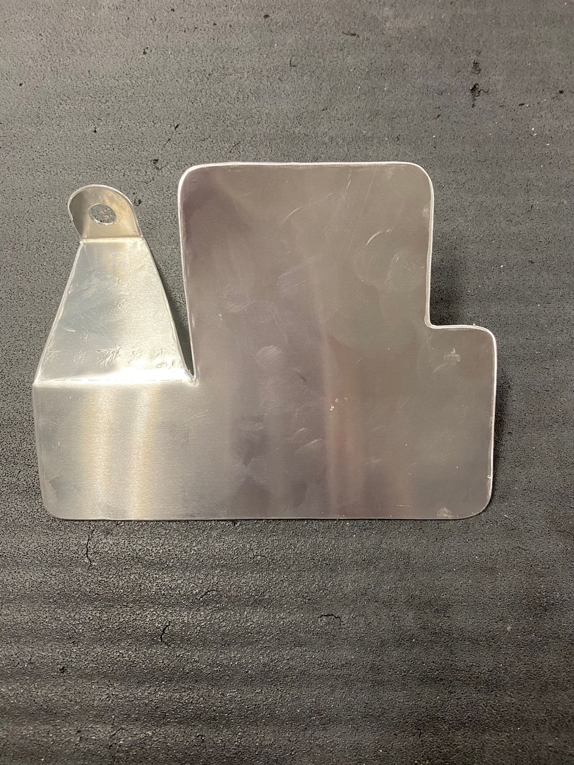

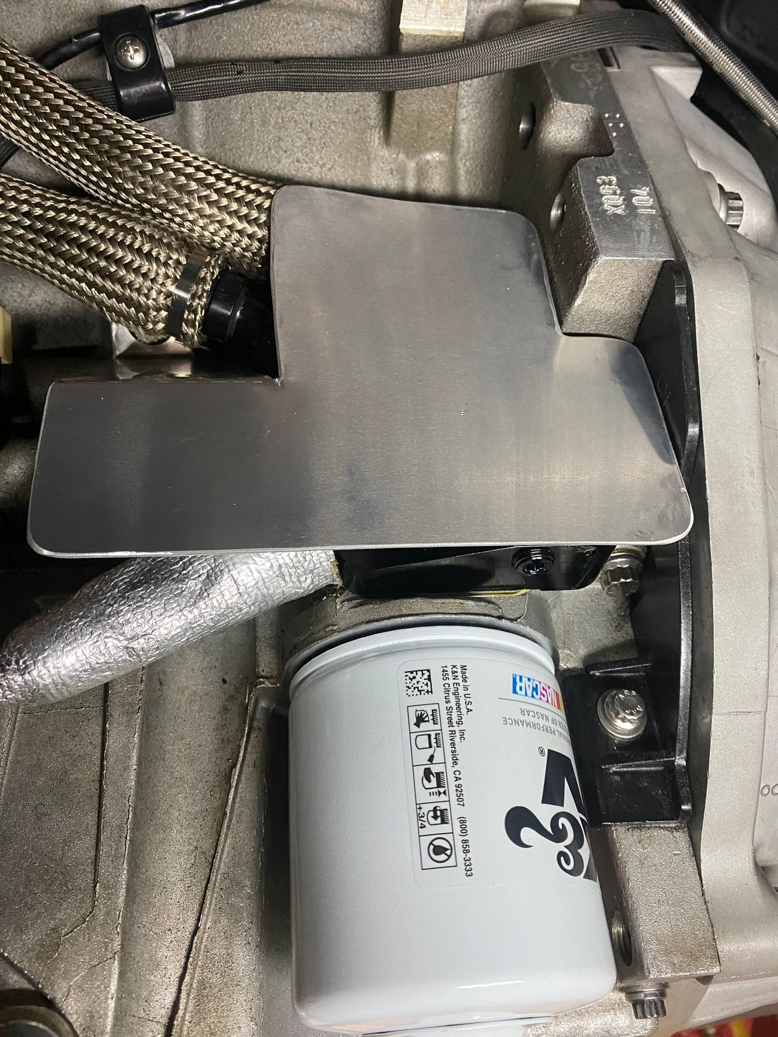

This is for anyone using the Improved Racing oil cooler adapter with a Dakota Digital oil pressure sender and long headers. I put various extreme heat sleeves on the hoses and wires in the area, but I needed to do something for the adapter. My solution was this aluminum heat shield that is bolted to an unused threaded boss on the side of the engine. This should help.

Wow, I didnt appreciate just how close that tstat was to the primaries. Neat little heat shield, I'll have to copy that.
