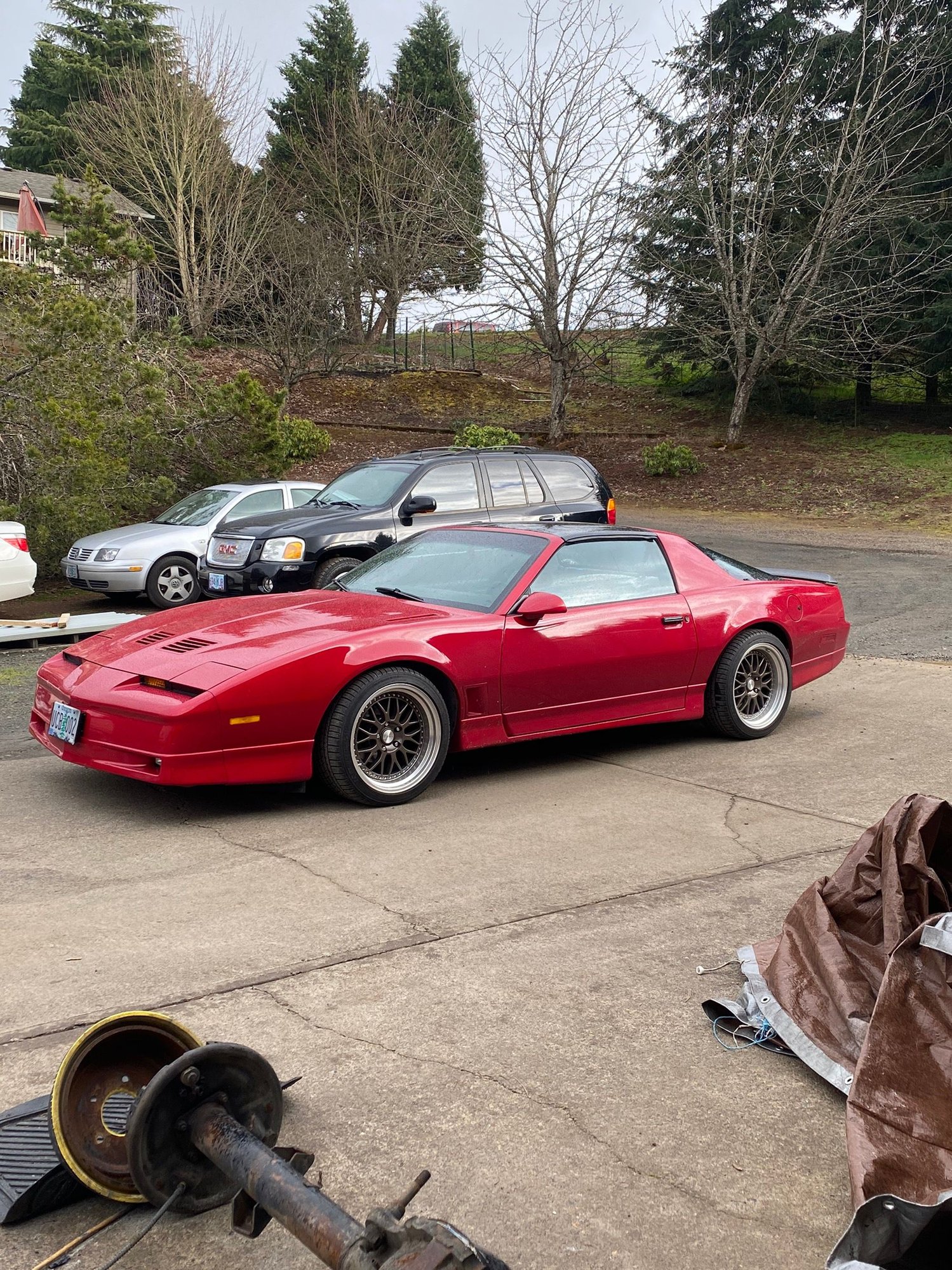

This is not a project to take on if you don't have a bankroll at hand. This is especially true if your engine-swapping experience, facilities, and tools are limited. From the pic you've posted of your car, I'm assuming it's in good, drivable condition; if so, enjoy it as it is while you start saving your $$$.
I was in your shoes at one time (a long time ago), and my intention is not to discourage you from getting into this hobby; I'm just trying to make you aware of the reality of how expensive working on old cars can be.
