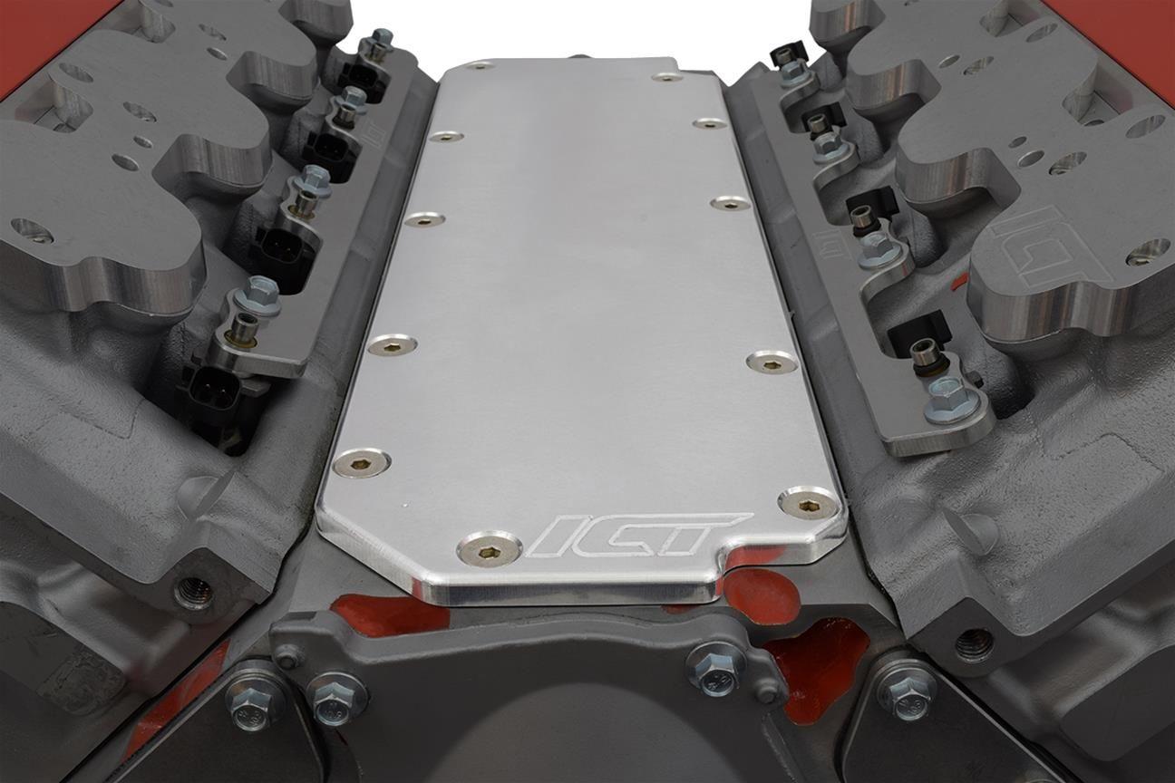

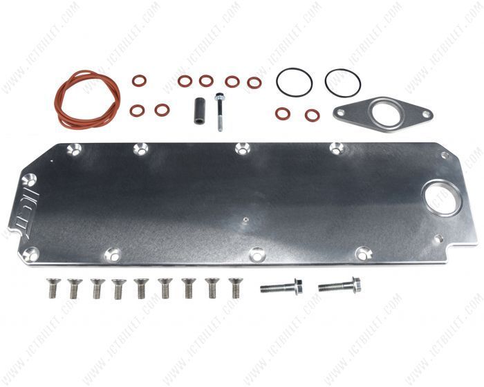

Are you deleting the AFM/ DOD System (Lifter Oil Manifold/ Valley Cover, Solenoids and Wiring, and 8 of 16 Lifters)?
You will be adding an Aftermarket Valley Cover and Set of Lifters, for No AFM/ DOD.
Are you deleting the VVT System (Camshaft, Timing-Set, Phaser and Wiring)?
You will be adding a new Camshaft, Timing-Set, and an Aftermarket Timing-Cover.
Are you deleting the Direct-Port Fuel Injection System (Fuel Injectors, Hard-Line Manifold, Mechanical Fuel Pump/ Regulator Assembly)?
You will be installing Pulgs into the Cylinder-Heads (where the Injectors were), a Pump/ Regulator Delete Plate, Fuel Rails, Fuel Pressure Regulator, Port Fuel Injectors, LS Intake-Manifold Adapters, and an Aftermarket LS Intake-Manifold (for Port Injection).
There is a lot more to show, than I posted.
Here is what stock looks like without the Intake-Manifold:
