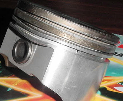

when rings fail, the rings themselves are usually the last thing at fault. It can be a result of rod angularity, bore finish, usage vs. lubricant type, lubricant type, cooling issues, too little windage, and the most popular washdown. I doesnt matter if your A/F ration is perfect now, if it ever wasnt it can shorten ring life. I recommend against using gapless on blown or nitrous cars. I do recommend TRW pistons though. But as far as gapless rings, I was told that pressure can build up between the top and second rings causing them to pressurize that area and 1) lock in the bore, 2) try to separate the top and bottom halves of the piston by ripping it in half. I didnt believe it when I was told and did what I wanted. This is what happens, you will notice the beggining of this phenomenon on the piston pictured. when holding the piston you can definitely see how the top of the piston is lifted even though the picture it is not really extremely visable due to the angle of the photo. TRW's are the toughest (albiet heaviest) off the shelf forged piston there is. some of the manufacturers can "build" you a tougher piston with special ring spacing. this wasnt found until the end of season tear down. Leakdown testing was within specification. See piston result here

Tom, I swear i've seen this post from you before.
