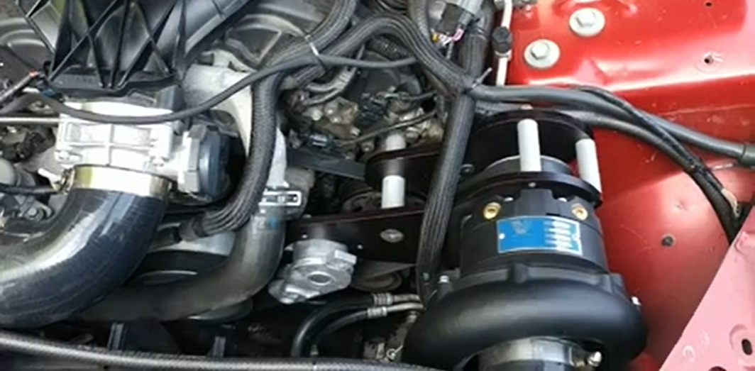

Let's say hypothetically speaking, a Vortech V3-Si fell into my lap w/ an air-to-water intercooler.
Let's say my T-trim's obnoxious whine has been driving me nuts.
Let's say the air filter being kinda over the exhaust has always been a thorn in my side as no matter what it picks up tons of hot air, and I can't really figure out a useful way to plumb it otherwise.
But the SI is CCW and I need a CW blower for my car so it won't mount as-is.
Would you:
1) Swap the volute and impeller, and use the nice quiet V3 gearbox, then selling the Si volute and impeller with the V1 HD gearbox (V1-Si HD was a thing so it's legit-ish)
2) Sell the V1 T-Trim as is, and buy an aftermarket volute and impeller (T-trim size)
3) Re-design the brackets to run the Si backwards, sorta like a C4 LT1 does, with the air intake down and front
4) Part out the thirdgen, and put the Si in my C4.
Current setup:
LT1 C4 for reference:

I never liked the ECS and HOB Corvette brackets that faced the blower frontward due to the lack of spacing between the blower and the radiator. In my opinion, if you're going to do that, do it the way Overkill Superchargers did by pushing the blower further away from the engine, as well as running an independent blower belt. Although this is a newer V6 application, the same principles apply because there is essentially the same amount of space to work with, or the lack thereof...
- Rob

The deal fell through, but you are right. I mocked up my T-Trim yesterday (backwards) and there isn't enough room to make the air cleaner work unless you put it WAY outboard, but then you end up with a stupid long belt.
I put the car back to N/A for now (so quiet now.. I'm at peace! haha) T-Trim is for sale. I might sell the vortech brackets / pulleys. I have another idea if I end up keeping the car. Will post a thread.
