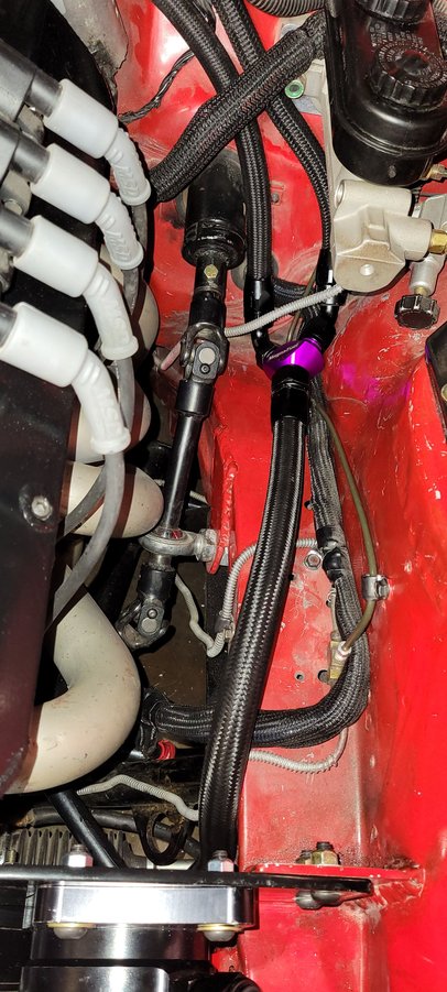

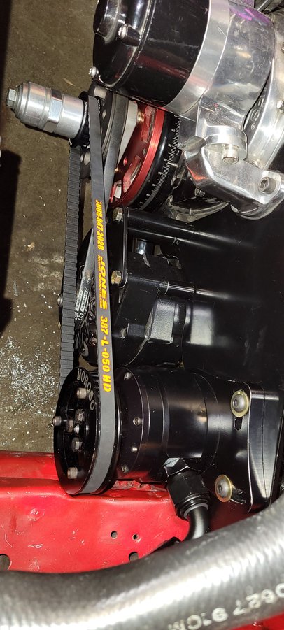

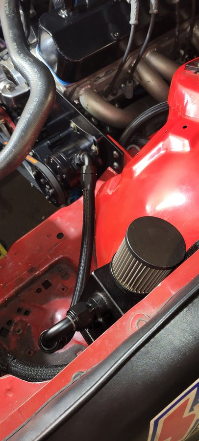

Re: Vacuum pump pics?

A vac pump set up would be a very expensive way to fix your problem.
A new pump like mine is over $800, then hoses, hose fittings, pulleys and a mandrel run off the crank.
I did mine to help with leaks, due to high compression, and help the nitrous tune ups and plug reading.
I'm hoping this gains me about 15 crank hp. Although that not the biggest reason to do this.
LiquidBlue
