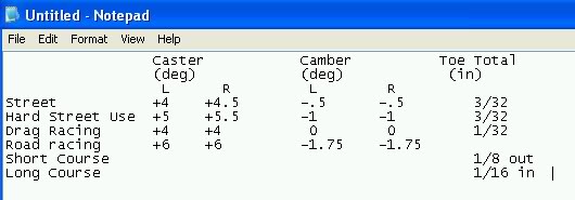

Tell em you want it aligned like this:
Caster: 4 - 4½° positive, R no less than the L to slightly higher (½° at most)
Camber: ½ - 1° negative, again R no less than L to slightly higher, ½° at most
Toe: IN, 1/32 - 1/16"
Nothing REMOTELY like the factory specs. If they refuse, and tell you they "have to" set it to the factory specs, inform them you'll take your money elsewhere, and turn around and walk out.
Fix the spring indexing first. Can't align a car that's inherently messed up. Just like a house; can't fix cracks in the sheet rock while the foundation is collapsing.

Do not use positive camber. and for chroist sakes do not go -1.0 camber either. Just go -0.5. One side could be -0.4 and the other -0.6 and that is withing enough tolerance you'll be fine. Just ell the tech to shoot for -0.5.
Actually on CASTER I'll give you a tip there also. Have the tech do the passenger side first and MAX out positive caster as far as you can go (trust me on this I do my own alignments of tons of friends with 3rd gens and well as I do race car setups in NASCAR. You then have the tech do the drivers side next keeping the left within .5* LESS then the passenger side caster reading.
Set toe at 3/32 in.
Remeber what I said about SAI. You need to have that within about 1* of eachother side to side or the car will pull under braking.
