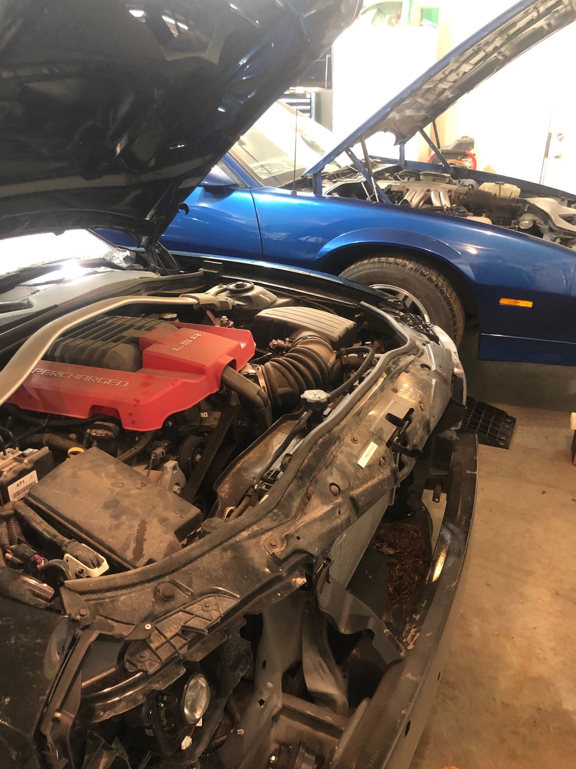

I have a complete 2015 Camaro ZL1 as a donor car for my 87 Iroc. What do you guys think about converting the iroc to the electric power steering setup?

Was just thinking it may be easy enough vs adding a power steering pump and there seems to be some benefit to it. I have the entire car so I am just considering hat I should keep and what I should ditch.

it was a write off at a local auto wreckers so I bought it. Only has 13,000km on it. 👌🏻
