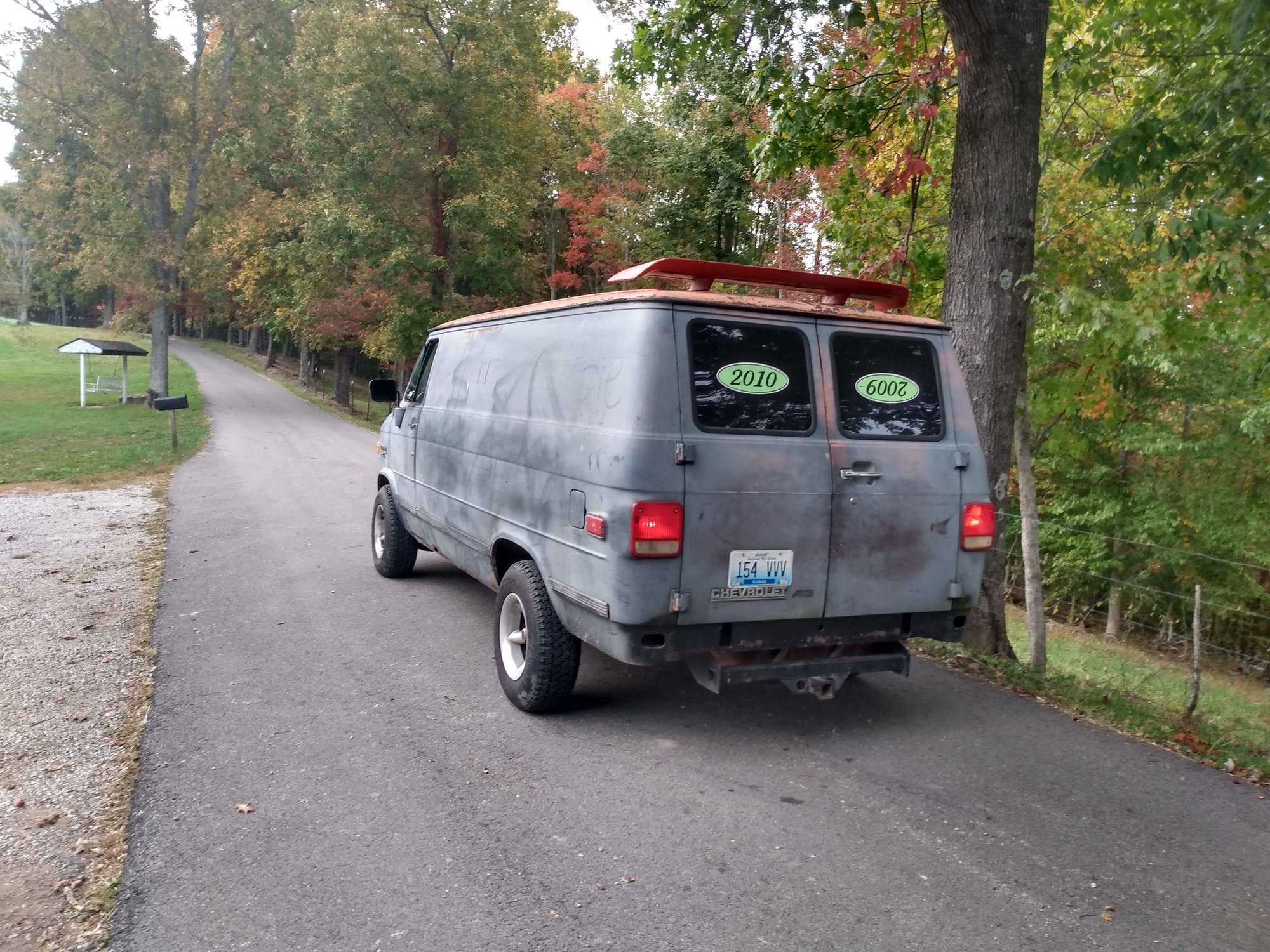

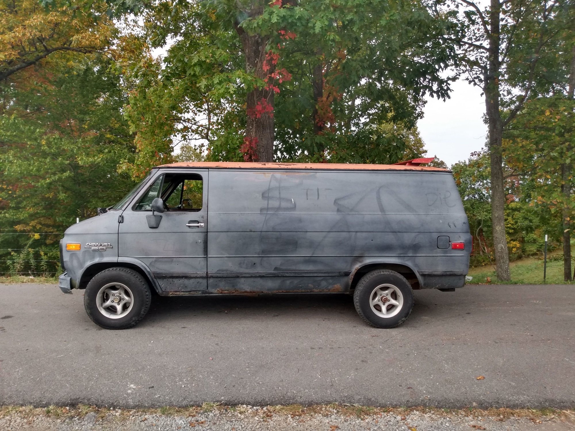

Sorry if this post isnt allowed since its a van. But anyway its a 93 cargo van long wheel base 305 and a 4l60e, it has 105k on it. Recently experimenting with it i inatalled a k1102 summit cam kit with a double roller chain as well. The results were better than i though they would be. Down low feels unchanged above aout 2800 it starts pulling much harder than before.
Ive got a very nice set of 081 heads to replace the 187 swirlies, im curious how they'll perform consodering they flow less on the exhaust side. After this will be a set if headers. Im told the 2nd gen Camaro headers are a direct fit. Then a nice dual plane intake and a tbi adapter.
Oh whats everyones thoughts on the bigger holley throttle body with the factory style injector pod mounted on it. That would be my last mod maybe..
I do have a 350 im building but this is just about trying to have fun with what I got.

I kinda like it -the light bar is a "hick"detail,but perhaps you are in a hick area.I have a '91 G30,so familiar with these vans.I think 187/193s are nowhere near as bad as the reputation would suggest-at least for use below ~5200 rpm.Beware using a 4bbl manifold with an adaptor to mount a TBI-I tried that once and the part throttle mixture distribution was very bad...perhaps someone else has had better results mounting a TBI on a carb intake than I did and will share some details on how it was done

Yeah im definitely in the country, helps on empty single lane roads to see deer too. I used a dual plane intake on a 350 with an adapter plate and a k1103 cam and it ran very well. Ive had lots of tbi equipped vehicles but i never really tried to see what i can do within reason. And most parts will transfer to my 350 when its done, probably late next year.

Wait you couldnt see the best part... The wing. Lol. Anyone care to guess what its from?

thinking about it,the module difference is spark advance instead of rev limit.The wing is cool

Its from a fiero gt, It looks ridiculous so it stayed..

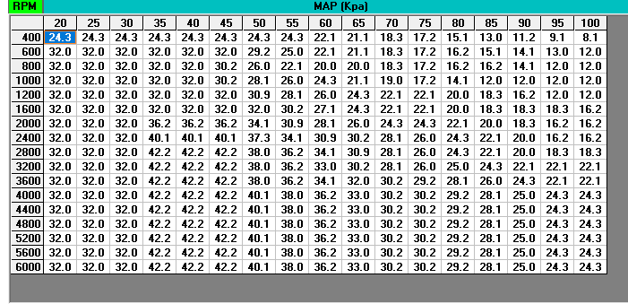

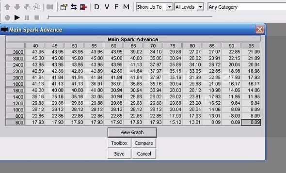

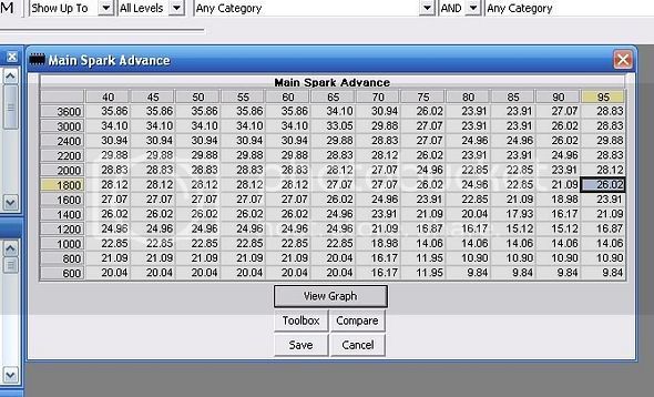

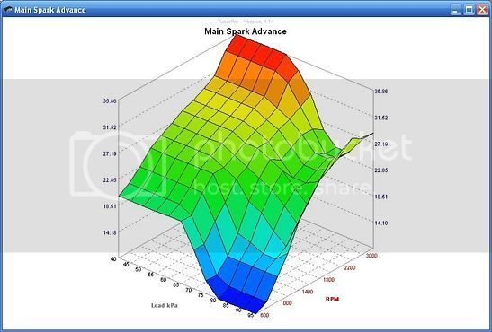

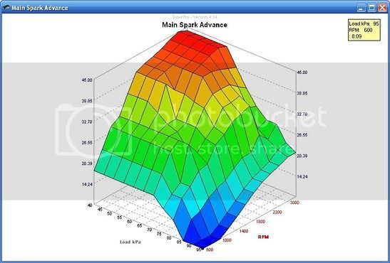

TPI Timing map has a huge hole in the midrange where the timing is retarded for the TPI units resonance effect on cylinder pressure. I used the factory CCC Q-Jet van timing table as a starting point for a TBI conversion on an earlier LE9 305 van and it worked well. I also have an 85 L69 Monte Carlo SS timing table and an 83 GrandPrix LG4 table. The non swirl port, non Vortec 305 heads are all similar in burn rate. Those being the 601, 416s and 081s or similar.
This is the LE9 van table. It is physically smaller with less resolution but fill in the values that match and interpolate the blanks between manually. Big box of a van does not need alot of WOT timing on 87 octane, will detonate badly on a long hard uphill pull with more than about 26-30° total. My standard HEI had 26° total at WOT and had a 20° vacuum advance canister giving 46° total at high rpm, light throttle on my 83.
This is the 83 LG4
This is the 85 L69 although I feel it probably has too much WOT timing for the van with its stock torque converter. Could always try it and see what happens. Then again you never know, my LE9 had factory flat tops with 6cc worth of valve reliefs and was higher compression then a TBI 305 with its flat top piston and 53cc 601 heads. It had a 194/203 @ 0.050 cam on a 112 LSA stock. Mine was also stock converter in the 700r4 and 3.08 gears. In addition to being lighter and more aerodynamic the Monte SS had a wider 115 LSA cam with 202/207 @ 0.050 (less cylinder pressure than a 204/214 @ 0.050 on a 112 LSA), a ~2,000 rpm stall converter and 3.73 gears. The Grand Prix had dished pistons and an 8.6:1 compression ratio with a 3spd TH200C and 2.43 gears. The LG4 also had the smallest cam at 179/194 @ 0.050 on a 109 LSA. The WOT timing on the LG4 was the least but so was its power output of only 145 HP.
Set the distributor to 6° and set the Initial value to 6° in the BIN file.

Thanks for those, I'll look them over and see If I can come up with something better. Here's what I'm running for now, There is still 9.8* of bias in this as well, I'm unsure if I should just zero that out when building a table??
Leave the bias values alone. Was that the stock table or after adding 10°? Assuming your initial timing value matches the actual initial timing value and you have not jacked with the bias values that map is not far off the stock CCC Q-Jet van. I set the Off-Idle and Idle tables to the same values. What module do you have? Is it a factory GM one? The 048 module will retard the timing over 3,500 rpm. The 369 module will advance it 2°. If it has a 369 module that will give you around 26° total timing. Might be able to sneak another 2-4° into it in places but you should not be too far off.
PS if the balancer ring has slipped replace the balancer. It is a bomb waiting to explode especially with the rev-limit increased.
