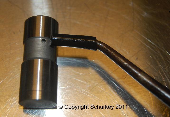

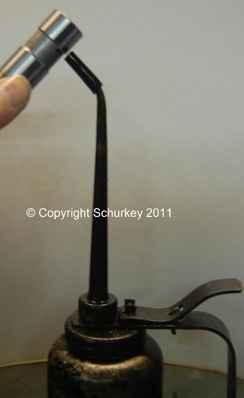

Or, after you remove the spring-retainer, pressurize them internally, so the plunger is forced out.
I fill the pump-oiler with clean ATF. Flows easier than engine oil at room temperature.

Thanks for the tip. A few more days in chemdip did the trick and I was able to get them fished out with a pick.
