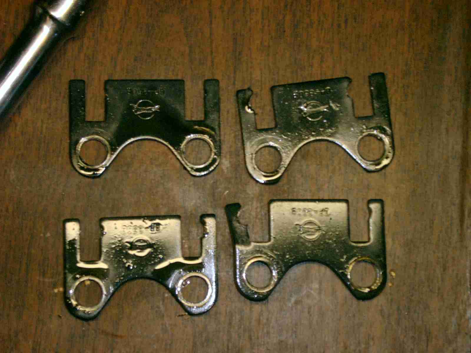

The lower right guide on left side was the one that failed. Upper left showed no visiable signs of wear except some discoloration and the others show signs of wear.

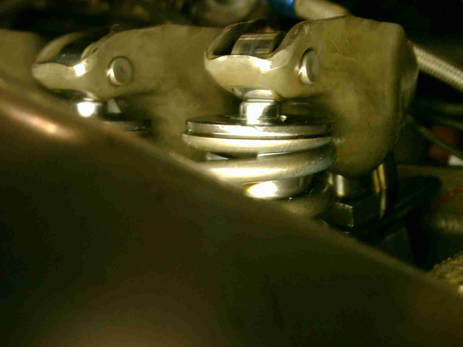

Close up of #8 cylinder. You can see the shiny mark on the retainer where the rocker tip came into contact with it.

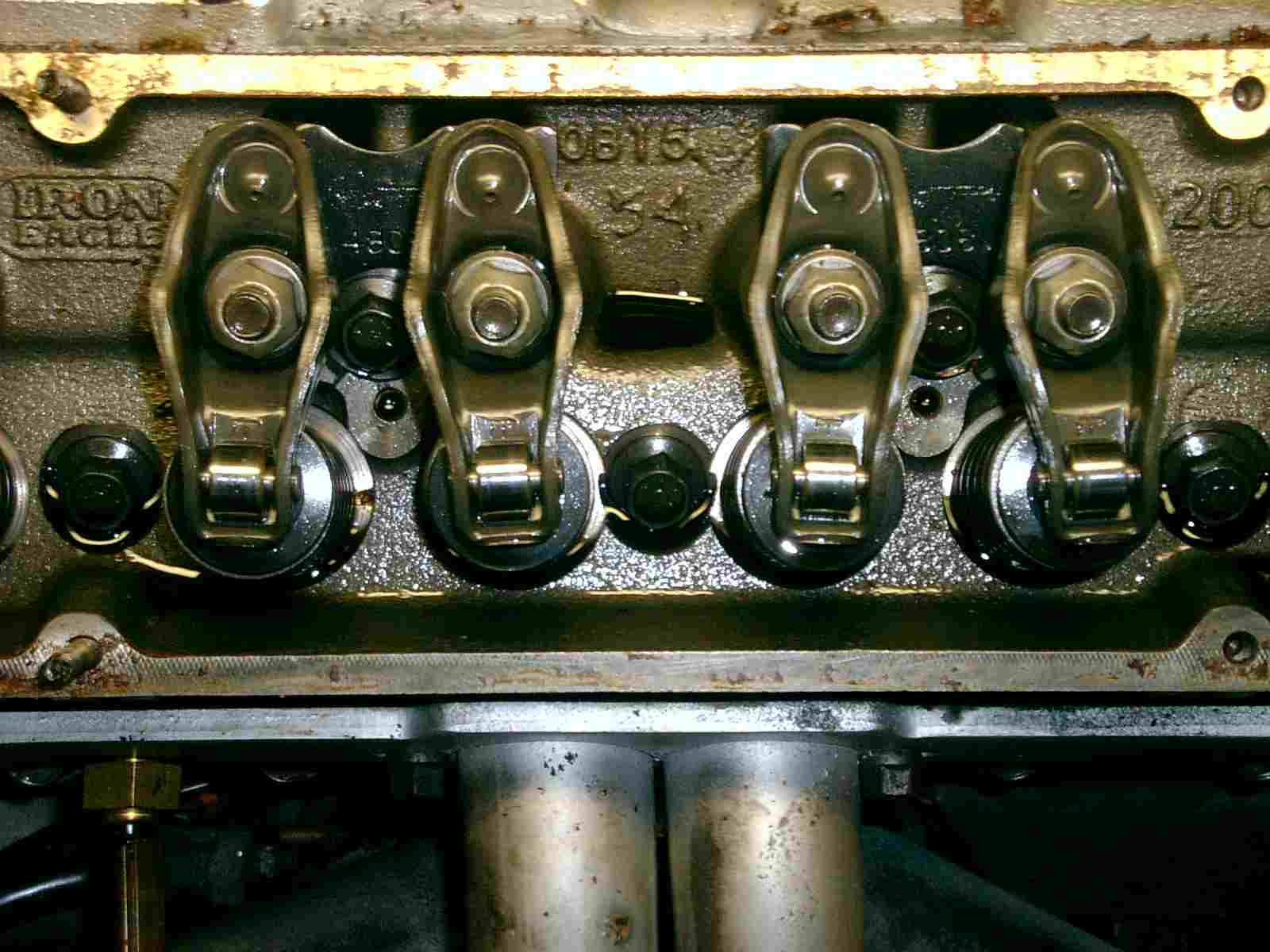

here is a clear pic of a couple cylinders to see alignment, how it is setup, maybe you can see something that I can't. Hopefully none of you are on a dial up connection. You'll probably want to shoot me trying to open up this thread! The guides seem to be holding the tips right on the vavle stems where they should be and their is not contact with the head but it is very close on some. There are no guide holes in the heads themselves like the stockers which you should be able to see.
Attached Thumbnails valve train problems need help!!!-clearpictoseealignment.jpg

The first thing I see that just jumps off the pics is that you have the wrong retainers... looks like 1.45" springs and 1.25" retainers. Measure the springs and get the right retainers.
They don't look like self-aligning rockers.

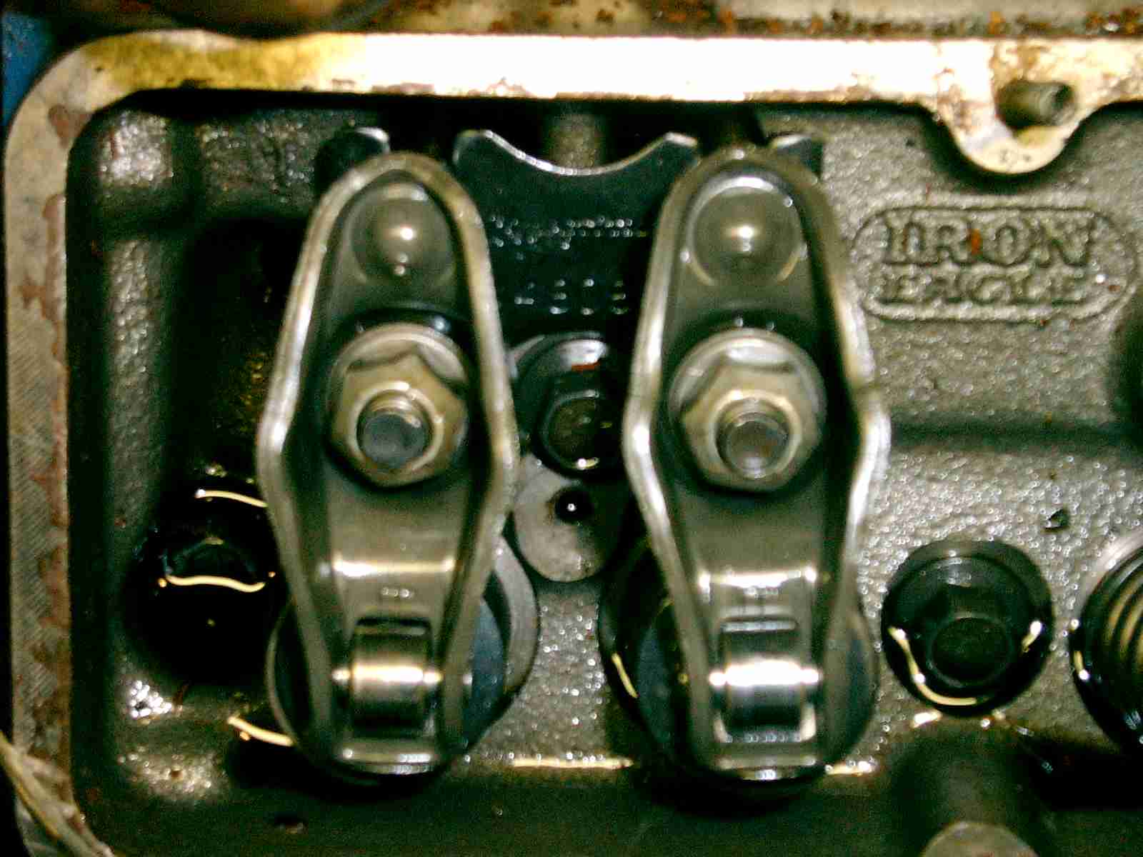

Can anyone make anything out of these pics to see what my problem might be? On some my studs they do not seem to lign up with the valve stem tip so the rocker is a little turned. But the guide corrects that and puts the rocker tip right over the valve stem tip so it would seem right. Is that slight angle putting too much of a load from the pushrod onto the guide while it is correcting the alignment?

You're right, I misinterpreted the pic, it's the spring pocket that's 1.45", not the spring itself...
You can either get spring seats from someone such as Comp (check their catalog at www.compcams.com ) or get the larger springs & retainers. I'd upgrade the springs, personally; but that's just me. I wouldn't spend extra money to preserve an inferior parts choice, if I was going to spend money I'd use it to improve something if possible.
It's normal for the rockers to be turned, in fact it's an essential part of the design. That forces the rocker tip to move at an angle across the valve tip i.e. out near the edge of the tip not straight across the middle, which forces the valve to rotate; that way it wears evenly all the way around.

I am running a Comp Cams XE 268 the lift is intake/exhaust .477/.480 . I guess that makes sence because their are hydralic roller lifters arent their. I guess some crazy grind for solid roller cams may be in issue.
RB83L69 I just have to say thanks for all your input! It is so hard to find people who actually know what they are talking. I'll see if I can find marks from the spring walking around and kick around getting new springs or seats. Anything else I can check for? Or just do springs or seats, run it and keep an eye on things?

No that's not a roller, it's a flat...but that's OK, those same lifters are used with bigger cams such as the very next one up in that series, the XE274, which is spec'd for the springs that you would be getting, as well as some REALLY huge ones. That's a good cam; I wouldn't get too excited about replacing it just yet. It shoudl be just fine once you get the other issues sorted out.

I know the XE268 is a flat tappet cam I must have worded that wierd. So I should look up the specs recomendations for the XE274 buy that spring and I will be set to run some big roller cams in the future if I wish and it might also resolve my current problem, correct? Thanks again for all your help!

It takes a massive amount of force to destroy a guide plate like that. These parts should show absolutly no wear or trama.
You'd best check the actual cam lift in your motor with a dial indicator before you run out and buy parts.
I'd say either your springs are near coil bind and you over reved it, or some other massive upset has happened.
Even if the guide plates were installed out of alignment you wouldn't see damage like that. Some thing about your setup is not as it seems.
Wouldn't be the first time a camshaft was mislabled.
I'd pull the cam and lifters for inspection too.
How's your valve to piston clearance? I would not assume any thing at this point.

My head is spinning trying to figure out why this thing failed. I check springs specs and took measurements for installed height coil bind ect. Everything looks cool.
So I started to concentrate on why my compression was so low in bad cylinder and I did the cranking compression test with and without oil in the cylinder. Well I got 50-60 without adding oil but with a couple squrits of oil it shot up to 100psi. So does that mean my rings are bad?
I will be pulling the engine soon but this sucks! I am going to miss woodward dream cruise. I want to have it back together soon so I can make it to the track for some 1/4 mile times. Oh well screw woodward for this year anyway those people are bruital! Unless you are driving around a $70,000 + car (oh lets say an authentic shelby cobra) people rag on you. I was going to hang a sign of my car that said "rag on my car if your gay" or "If you like to chew on wrinkly sacks and rub ball sweat on your face make fun of my car". Can ya tell that place left a bitter taste in my mouth. Who am I kidding, I will be back reguardless because I love to look at all the sweet cars! I just need to get some paint on mine!
