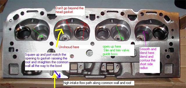

Attached Thumbnails Porting new heads!-15a4c6d8bc438d44a123cc57a1a559691.jpg

Watch how much you remove from the chamber while unshrouding. It will reduce the compression ratio.
The valve guide bosses are huge. Slimming and trimming and streamlining them will help a lot.

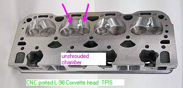

Here is a properly unshrouded head.
You can do yours simular to this.

Before you do something like that you should CC each chamber and find the biggest one. Then clean and unschrowd that chamber not only like you want it, but how safe you feel doing it. Then unschrowd the rest of the chambers while matching the volume in Cc's to the fisrt chamber you finished. Then surface the head to bring the volume back to the desired CC's. Does that sound like a simple task ?
I hope your packing a fat wallet. You slip while trying to unschrowd valves that aggressivly and your either needing a new head or a repair.
