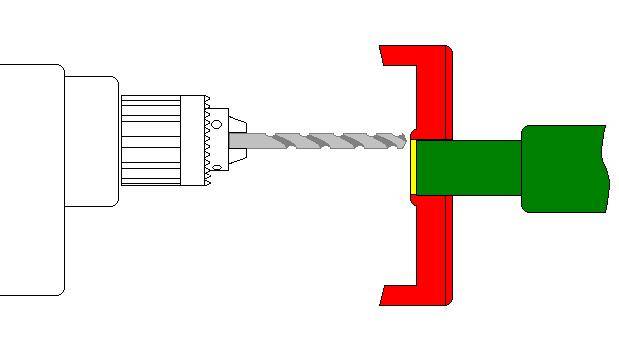

Another possibility is a new key - a round one. There are several industrial applications that use round keys instead of square or Woodruff, and in a helluva lot higher stress than any thirty gasoline engines together would ever see. The repair takes a little preparation. Drill small (about 1/8") longitudal hole at the intersection of the crank snout and the balancer hub (so that half of the hole is in each part). Drill about 1½" deep. If the hole is straight and where you want it, step the drill size up to about 3/16-13/64". Using a small tapered reamer (about a Morse 6 or 7) and cutting fluid, start reaming up the hole for a taper pin.
Check the size frequently to make sure you don't over ream. When it's close, insert a 6 or 7 taper pin with a tapped end (for removing with a slide hammer) and lightly tap it in place so that it's fairly well seated. Mark the depth, then remove it. Cut the pin just slightly longer than the marking so that the heavy washer under the crank center bolt holds it in place. Tap in the pin and finish assembly.
When you're ready to pull the balancer hub, rememnber to pull the taper pin first. You won't be able to use the crank again, but it's already trashed. You COULD re-use the damper, but I wouldn't - especially if you're changing strokes.
You can find tapered reamers and taper pins (by the bag full) at any industrial power transmission supplier or general supplier like McMaster, Fatenal, Grainer, or MSC.
If you were really cheap and dirty, you could drill and tap two holes at the intersectio at end of the crank, just as you would in a taper bushing. There are plenty of 200 HP and large electric motors with couplings and sheaves attached that way, and they see 200+HP all at once - as sonn as the power is turned on. .
