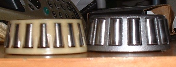

ok so i got a set of Timken wheel bearings to replace since i am doing my front end. and the supposive new outer bearings (set 3) are larger in diameter and height then the old ones.. also the rollers are ALOT larger and the bearing won't fit into the exisiting rotor, and i odn't know how to get the old sleeve out of the rotor to replace with the one that came with the new bearings. what am i missing?!?!

looks like your missing the right set of bearings. The whole thing should go back together without much throuble. Oh, make sure to get new rotors as well since the bearing races are machined into the rotor. No sense in using old worn rotors with new bearings.

You got the 1LE bearings.

ya i realized that after doing ALOT of searching. stupid autozone computers not even asking if i had heavy duty brakes or not.. getting the right ones tomorrow. i think they are set34 right?
Set 34 sounds right.
To get the races out, you'll have to pound them out from behind. They are a press fit.

what about when installing new races in new rotors?
All new rotors I've bought came w/ the races already pressed in. Check 'em at the counter.

If that were so, wouldn't the new rotors have come with bearings?
Just tap slow; make sure you seat the race all the way. You can't drive it too far into the rotor; it'll stop where it's supposed to. Some guys use brass punches for this; some guys use a special bearing/race installer like this one: http://www.eastwoodcompany.com/aspfi...0.asp?T1=49048 I just use a hammer, and tap lightly. Be careful not to score the inside of the race, obviously
