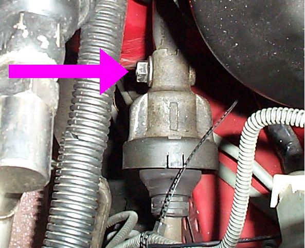

Jason,
Check this bolt/nut:
...and these four bolts:
It's a good idea to remove the bolts one at a time, apply Loctite 242, and reinstall them. Tourque to 120-150 in/lb.
