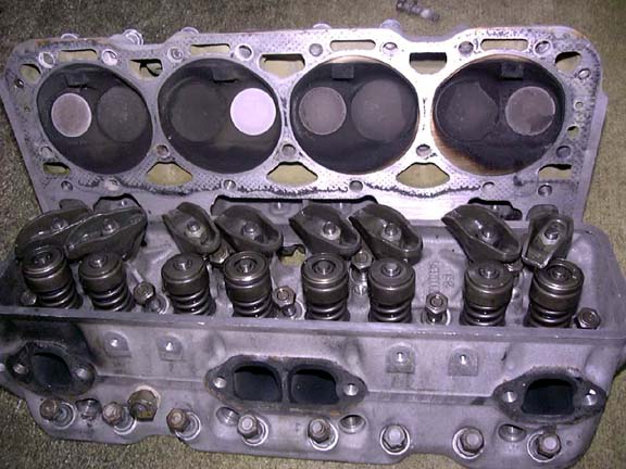

Thanks Vader. From the picture below it looks like the heads have centre bolt valve covers. Are you certain they are perimeter?

Those do appear to be centre bolt heads, yes. By the cast # they are 86-87 Aluminum 58cc angle plug heads. Perimiter bolts heads have holes around the outside along the gasket ledge. Those can be fun to yes headers with due to the angle plugs.

Thanks for confirming what I thought. I have SLP 1 5/8 headers I'll have to search if vette heads with angle plugs are OK. Not having the raised exhaust ports they should match the headers better.
