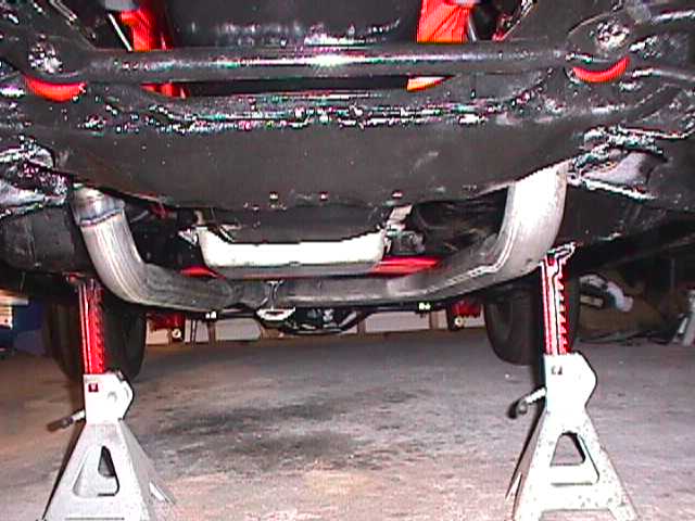

Here is a picture of my exhaust, so it will clear:
Attached Thumbnails Oil Pan Question-cust-1-.-y
Old Oct 5, 2003 | 02:04 PM
onebinky's Avatar
Joined: Apr 2001
Posts: 2,031
From: Southwest Chicago 'burbs
How much ground clearance do you have with that? Any more pics of how it is ran?? I'm looking to do that too, but the roads around here are crap and I don't want to smash my pipes.
Matt

Here is a link to the setup:
https://www.thirdgen.org/techbb2/sho...hreadid=155711
