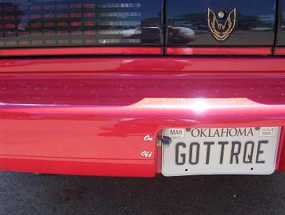

My battery is set up just like the above post. I'd be happy to answer any questions also. Here is the location of my cutoff switch.
Some tips...
0 Ga. Taylor power wire from summit
4 ga. welding wire to run from alternator post to starter post
use convoluted tubing, careful to avoid exhuast and trans heat
be EXTREMELY careful about chafing-- there is really no fuse unless you run a solenoid. This setup can burn down your vehicle if not done correctly. Check it regularly.
Secure wires with zip ties
Use piece of plate to distribute force of battery bolts in rear well
Use grommets through body
Moroso sealed battery box w/ vent through floor
Solder copper lugs to ends, available at the parts store
I used marine terminals (wing nut/stud) to aid in removal.
Use liquid electric tape on cutoff switch terminals

i really like how you placed your cutoff switch. you wont mind if i somewhat copy that when i move my battery do ya? it looks super clean right there.

No, that's fine... that's why I posted it! I cringed at the thought of ruining my bumper cover or my tail lights. At one time, I had the switch in the center tail light...hated it. As far as I know, I've never seen anyone else do it like I have it. It is super clean and nearly hidden to most passers-by. This is good b/c no wise-guy comes and plays with it, making you loose ur radio stations, ecm memory, or whatever. It becomes nearly invisible if you take the lever off of the switch w/ a simple flat head screwdriver. You have to have the off position marked clearly for track use. I had those stickers made from high performance vinyl at the local sign shop. You have to cut away a little of the crash material. Be sure to take out enough or your bumper might bulge and spider your paint.
