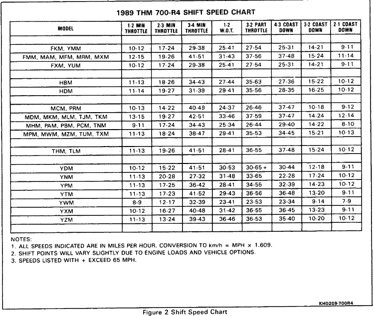

For what it's worth, here is a 1989 THM 700R4 shift speed chart for all the various models.
Attached Thumbnails 84' ta has trouble shifting into 4th when flooring it-23.gif
