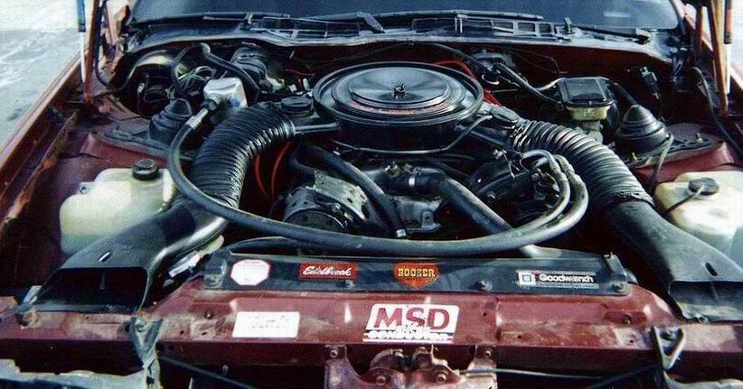

Since there were no 88s with a dual snorkle from the factory you'll just have to estimate it from my picture of my 86.

I think it should work. But it might depend on how your AC hoses run....
EDIT: I just noticed that the one in the pic above isn't an HO car by the way the AC hose routes!!
Only reason I know is because I have a HO car! That hose doesn't normally run over the pass. side duct ....

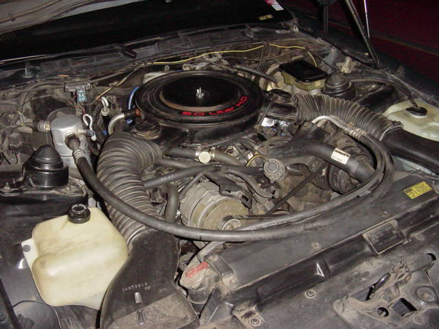

One of the more subtle differences between an L69 car and an LG4 car...
Attached Thumbnails 5.0 H.O air cleaner and A/c compressor?-camaro-engine.jpg

Old Oct 11, 2004 | 05:15 PM
five7kid's Avatar
iTrader: (14)
Joined: Mar 2000
Posts: 43,187
Likes: 46
From: Littleton, CO USA
Car: 82 Berlinetta/57 Bel Air
Transmission: 4L80E/4L80E
Axle/Gears: 12B-3.73/9"-3.89
The housing looks different.
