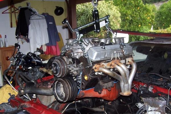

Originally posted by ME Leigh
Let me add alittle to that, the dipstick won't work if your running the stock exhaust manifolds. You might actually get it to worj though with a little finagiling and bending.
Now the dipstick will definitely work if your running headers.
yup you are right. For the stock 400 oil pan it should fit with no problem
