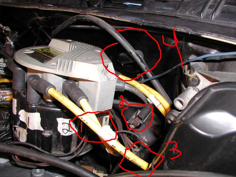

Just gonna use this thread for my problem.
I pulled distrib to swap manifolds. First time pulling distrib for me. Well I havent got it running. I want to make sure I got the wire harnesses connected right because I pulled some wires without labeling. In the pic, there are 3 wires labeled. I want to know if the number 1 wire(brown connector) that goes to the cap should come from the wireharness below or that thing labeled number 4? Also, under the accel super coil there are two wires, one red and one yellow, do they just drop in on their respective sides?

Can anyone help me with the diagram 3 posts ahead of this. I want to make sure I wired it correctly.
They all look correct, most connectors that look the same will have different color wires, and are keyed so you can't mix them, but I can't say it won't happen.
