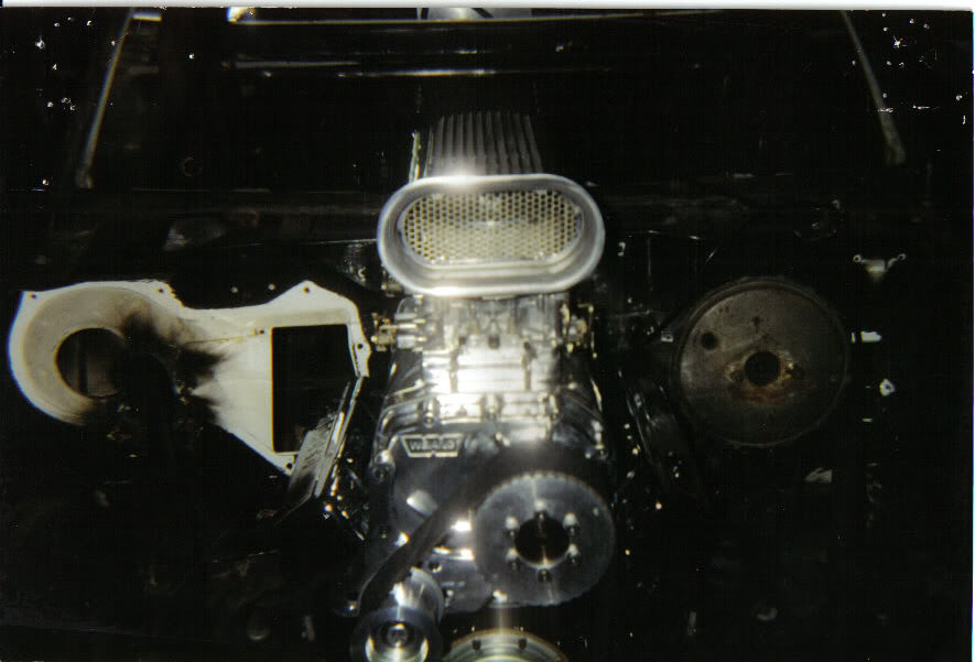

i dont thnk i should have ever worked.
steel heads to boot.
i ran with 34 deg of timing and a btm to pullout timing when i was in boost.
it was a 6-71
pic
this was taken when i was tubbing it.
i made one pass on street tires and 94 pump gas
mt sportsman 31x18.5x15 and 4.56 gears
it hat a 3.3 60 ft and crossed at 130 mph. lol
i felt like john force couldent get boost because the tires would lite up
i ran it on the street for about 1 year before i sold the blower to go turbo.
the same motor was in the s10 after that on spray running 9.93 at 134.98.
so the blower and pump gas didnt hurt it.
