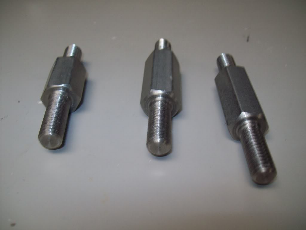

I made up some standoffs. 3/8" thread and flats to use a 9/16 wrench. Unfortunately I made them out of stainless, so they warped a bit from the heat. I'm thinking of making them again out of steel and just painting them.
Think there would be much of a market for these? Obviously needing different lengths for different flange thicknesses.

I got the CAD files drawn up and am waiting on a quote for the prices in both plain and stainless. Design is changed a bit to keep costs somewhere around $20 for a set. Things are taking a bit longer with these 12 hour days at work this week.

Those are beautiful braces. Like Uncle Tom, I made mine from thick wall 3/8" pipe. 1" and 1-1/4" sounds about right for the lengths when bolted to headers with typical 3/8" thick flanges. I reused the stock double-sided studs from the stock manifolds with mine in those two locations (regular header bolts everywhere else), which was very functional and made for easy removal of the accessories when required.
My spacers were steel, so they rusted and looked crappy. Aluminum or stainless would be longer lasting from a visual beauty perspective.

Well, I'm going to try and get a pic posted tonight. After I got this first set back, I'm beginning to think this whole thing might not work out due to price. But so far I have nearly $25 in a set after paying for materials and labor. So I can get them shipped for $30 and that will leave me with no profit which I really don't have a problem with because this whole project was to help my friend start his machine-shop and get him started paying off his equipment.
Stainless would be $30 shipped and plain steel would be something like $25 only due to the difference in cost of materials.
If I can get some opinions from others if these prices are acceptable and more orders are made, prices could drop by up to $5.
Let me know what you think. If you still want them after you see the pics, just let me know.

Here's some pics of the Stainless ones. All that would be required is a 5/8 wrench for the stud and a 9/16 for the nut to hold the brackets.
All that's needed is a quick once over with a buffing wheel and you're golden.

I woould recommend hardening them with some sort of tempering. Stainless is not something you want breaking off in a cyl head

Just out of curiosity why would tempering be needed? 18/8 stainless steel is slightly stronger than grade 5 steel. The original bracket bolts were most likely grade 5 or lower. Not disagreeing with you just curious as to your reasoning.

Because the bolts in question go to the exhaust and factory exhaust bolts are notorious for snapping. Same strength as stock may not appeal to everyone

I got the off-sets today and they look great! Now I jsut have to find someone to make stainless steel brackets!
By the way, this may be a retarded question but why are there three? I know one for each side but I am confused about the third one.
Thanks!

I hate quoting pics, but you can see the stubby one there

I went ahead and had the rest of the material used up, so by the end of next week there should be roughly 8 sets of each availible if anyone is interested. I started a new thread in the exhaust section for it if you do a search for accessory bracket studs.
