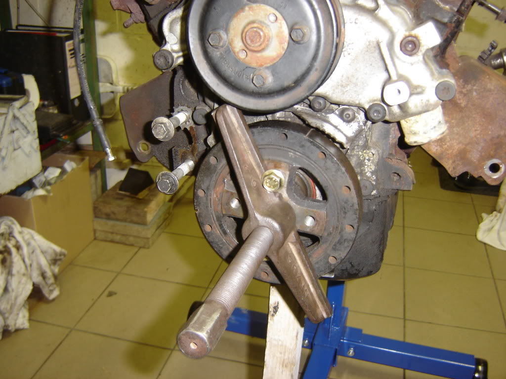

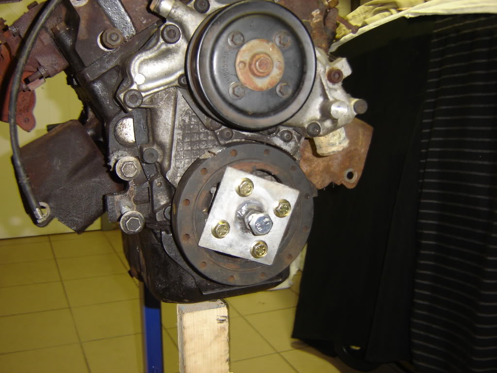

Because of expensive shipping costs, I wanted to make sure to order all parts in one shipping. So the hb had to come off first to see which parts are needed. I first made a tool myself but that didnt work. I probably should have used a 12.9-grade bolt instead of a 8.8.
So I took my big puller, undid it of his arms and pulled on the bolts. It came of very easily.
Shoud I still order the instalment tool or will a long bolt with large washer work too?
Thanks.

Order the installer, or make your own. Do not pull the balancer on with the bolt.

NAPA 7753901, about 27 bucks and you'll have the right tool. Yes, change out the timing chain and gears.

May have misunderstood you but unless you want to use thread locker,retap your harmonic balancer crank threads, or end up using a heli coil kit like I did, I highly recommend you spend the extra money and not use a bolt and washer to press the balancer on the crank.
