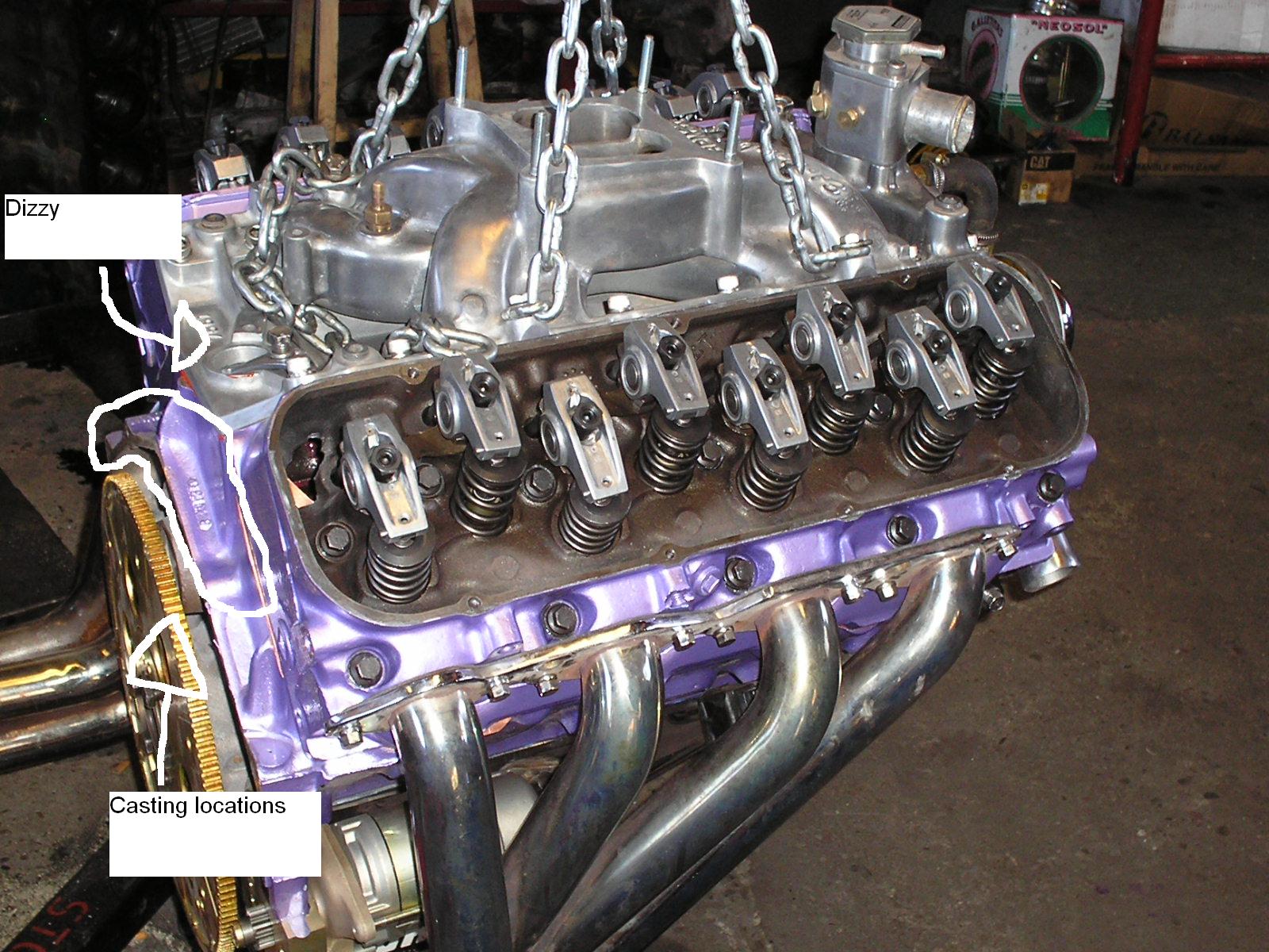

Re: Engine id number??
Originally Posted by tylerv350
im pretty sure thats it, i think i did misread it. thanks a lot, ive been trying to figure it out. pretty sure that its permiter valve covers, dipstick on the passenger side, and thats all i got on it right now until i can get under the car.
The casting id number for the block is on top and to the rear. It's not on the bottom.

guys i still got nothing, even with zhb. this is gettin to be a pain. can anybody help me out any further? i just need to know what kind of engine is in my car haha
... Measure the diameter. If the measurement is 4 inches across, or 327. It's not that hard to get the casting off the top/back of the block. All you need is a flashlight, a dentist mirror (small mirror attached to a rod), and a bit of patience.
