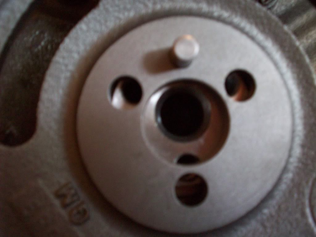

hey guys
so im in my garage r8igh now putting ym engine together and i got my new lt1 style (i have a tpi) comp cam in thhere and the dowel pin wont let the timing gear line up corrrect, do i need to pull the pin out or am i boned???

Re: new cam install problem! help quick!
The dowel pin won't let the timing gear line up any way but correctly.
its pushing it like 1/4 in to far to one side of all the holes
You're using the wrong timing set.
god damnit, really starting to hate these speed shops, my oil pickup is wrong to
"for lt1 or l98 engines (pre 1996) the dowel pin in the end of the camshaft must be pushed in so extension from end of cam is .30"+-.01". for 1996 lt1 and lt4 engines, the dowel pin is in the correct position extending .620" from the end of the camshaft"
straight out of GM Performance Parts catalog. hope this helps
You have the wrong timing set. you need a timing set for a 87+ engine, that is cleary a timing set for a 86 and below flat tappet engine.
