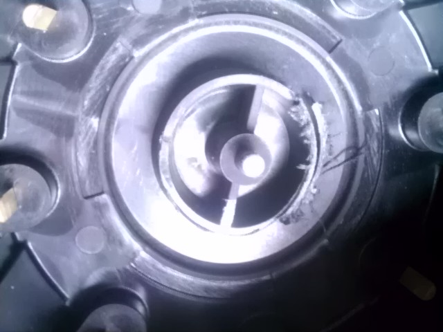

juanillox8 & I figured it out this morning. Distributor cap wasn't seated correctly and got chewed the &%$# up along with the rotor when it spun! DARN IT! Just walked to the Auto parts store and got another one. Lets see if it works. Someone learned about caps and rotors today

figured it out urself buddy ....line up the cap with the groves on the ignition mudule first and them tighten it... thats how you know its sited right
