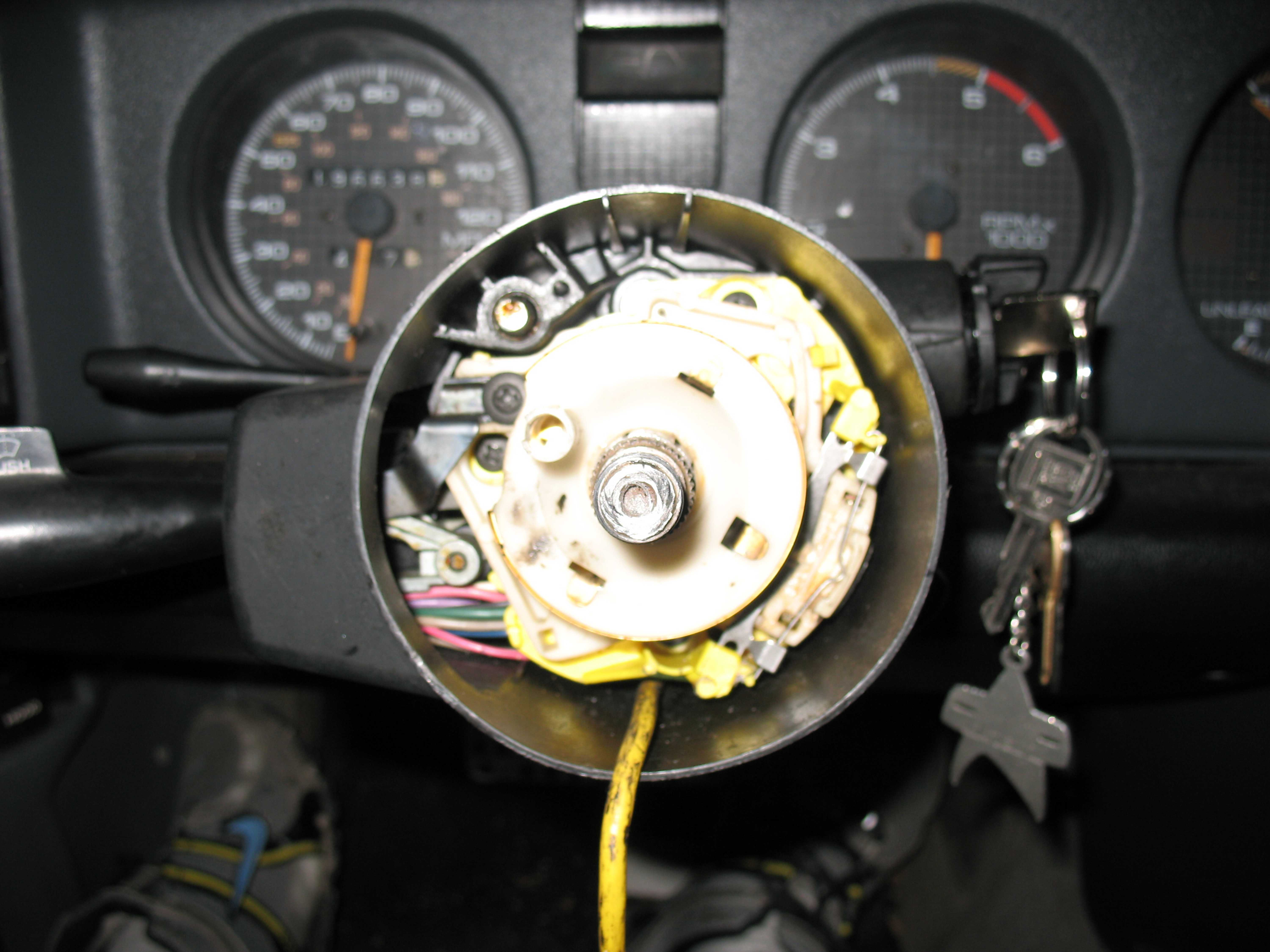

Keep in mind i have a '91 firebird but i would think they would be close enough. Sorry no pic of the steering wheel puller. I was in a hurry and tired of messing with the thing. =)
Attached Thumbnails Where To Buy VATS Lock Cylinder/Is This It?-step-1-remove-air   Where To Buy VATS Lock Cylinder/Is This It?-step-2-remove-air   Where To Buy VATS Lock Cylinder/Is This It?-step-3-use-lock

Re: Where To Buy VATS Lock Cylinder/Is This It?
Make sure these parts are snug or you'll bend them when you put the lock plate back on and have to new ones at a junk yard cuz they are discontinued.
I know that firebird steering columns are compatible through at least 1995 (I had to get another lock plate and the parts pictured).
Hope this helps or at least saves you a headache. There are other step by step instructions on here but i don't remember where they are.
OH! Another piece of advice. If you've never removed a steering wheel. It should pop right off. If it doesn't you'll bend a screw on the puller, this means it isn't on right. My wheel was very temper mental. One time it would come right off, another it was very stubborn. Remove the puller and reconnect it and keep doing that until it works with little effort.
