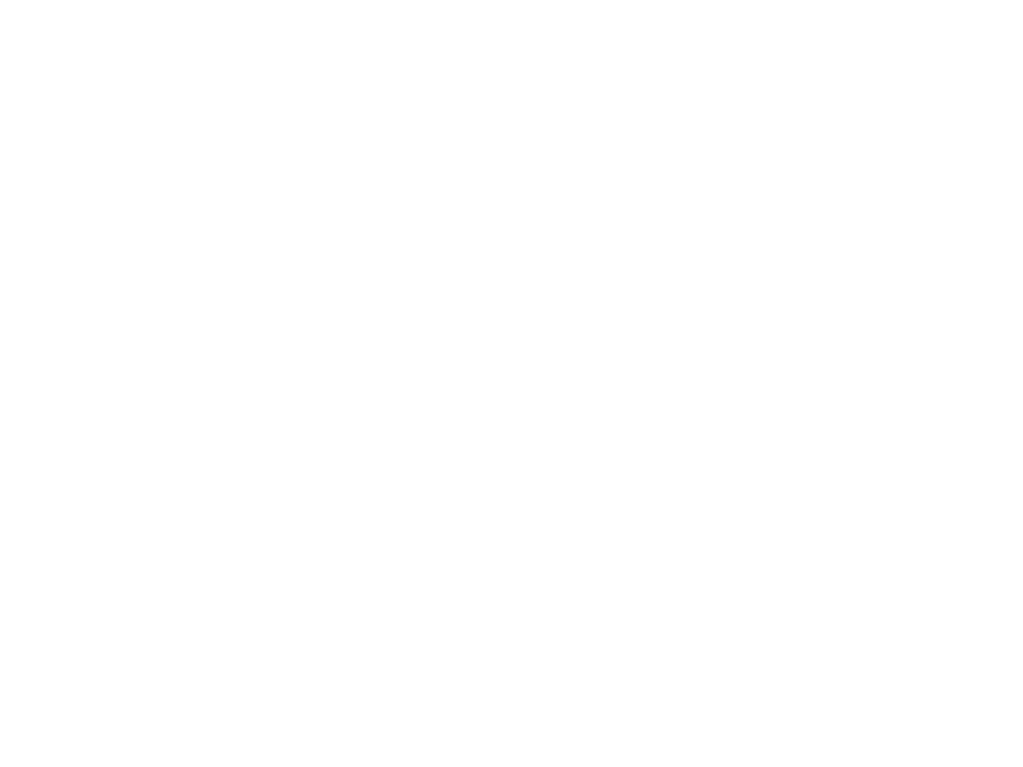

yea is your fuse panel under dash labeled? and visible
Old Jun 15, 2012 | 06:32 AM
Brynpowers's Avatar
Joined: Jun 2012
Posts: 22
From: Arkansas
Car: 1987 Firebird
Engine: 2.8l (173cid)
Re: 1987 firebird problem HELP!!!
yea lol but the lables are not able to be read so what do i do??
Old Jun 15, 2012 | 07:55 AM
84firebird1996's Avatar
Joined: May 2012
Posts: 125
From: SOUTH TEXAS
Car: 1991 Trans Am GTA
Engine: LT-1
ill get you a diagram asap.
Old Jun 15, 2012 | 08:01 AM
Joined: May 2012
Posts: 125
From: SOUTH TEXAS
Engine: LT-1
Joined: May 2012
Posts: 125
From: SOUTH TEXAS
Engine: LT-1
HEllo it appears as the image doesnt show just right click on the empty white area and click View Image and you will see it.
Old Jun 15, 2012 | 08:21 AM
Brynpowers's Avatar
Joined: Jun 2012
Posts: 22
From: Arkansas
Car: 1987 Firebird
thank you tons!!!!!realy appriciate it!
Old Jun 15, 2012 | 08:28 AM
Brynpowers's Avatar
Joined: Jun 2012
Posts: 22
From: Arkansas
Car: 1987 Firebird
can you send me the link to the picture i still can not see it i dont know why..?
Old Jun 16, 2012 | 03:18 PM
Joined: May 2012
Posts: 125
From: SOUTH TEXAS
Engine: LT-1
Here. https://www.thirdgen.org/forums/atta...rs-fusebox.png
