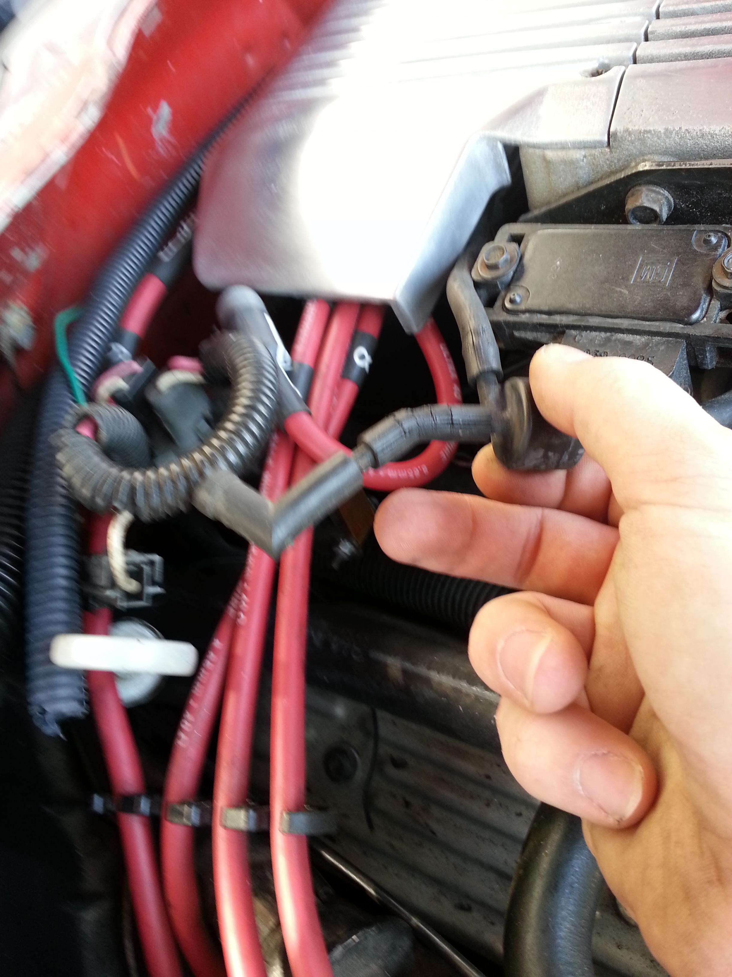

Old Sep 7, 2012 | 12:19 AM
formula forever's Avatar
Posts: 1,204
From: chicago IL
Car: 91 formula
Engine: 350 tuned port. bolt ons
Re: fixed heater core. now won't blow out ac vent
anyone know where this vacuum line plugs into.

Old Sep 7, 2012 | 07:24 AM
TTOP350's Avatar
Posts: 12,228
Likes: 1,156
From: Il
Engine: 4++,350 & 305 CIs
The elbow plugs into a hard plastic vac line that goes into the inside of the car to run the HVAC doors.
Those little rubber lines need 2 be replaced.
