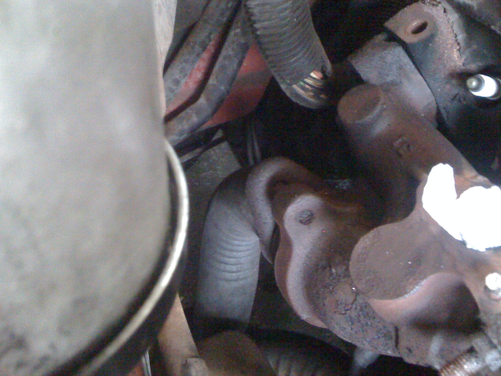

HMmm , From your description , I wonder if your possibly having wiring harness issues ? ..... Specifically , a connector with corroded pins or maybe a wiring harness slowly cooking on a manifold like mine was ? I had all kinds of weird electrical malfunctions that came and went that turned out to be the wiring harness being fried by an exhaust manifold (I'll try to post a pic) ... The problems were intermittent just like you describe , and all went away with the repaired/repositioned harness ...

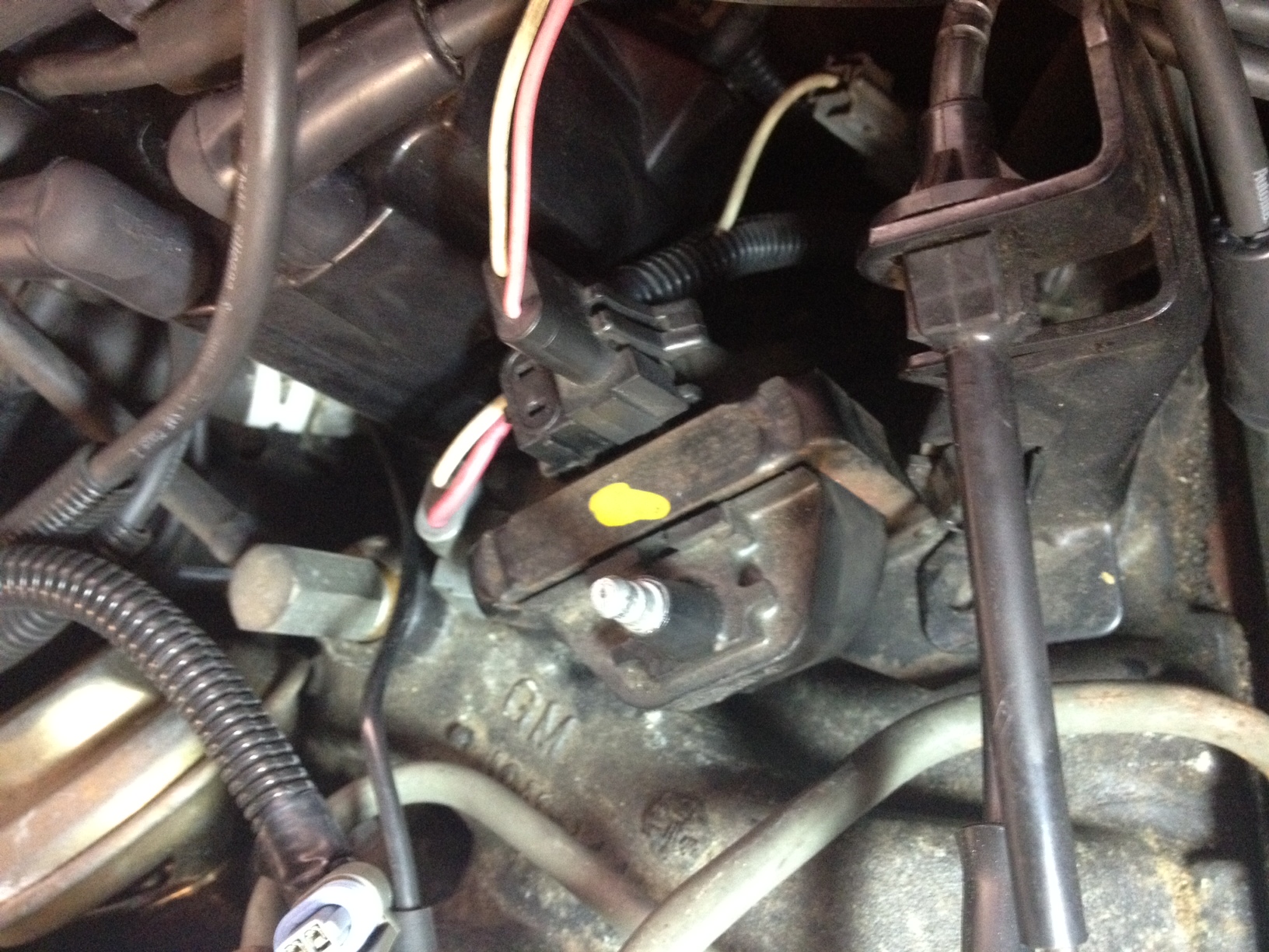

Interesting finds. I took the air cleaner off today, and low and behold, I found out the coil was completely unbolted from the block and just dangling by the cable that runs to the distributor. What a surprise! I don't know what kind of nutcase last worked on the car, but he completely forgot to bolt down the coil.

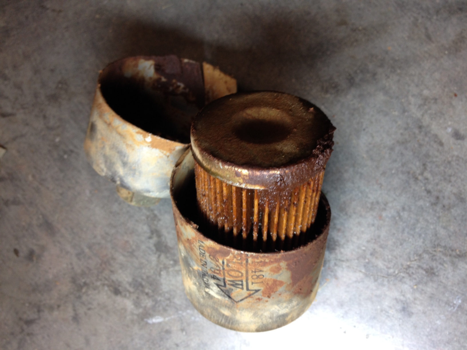

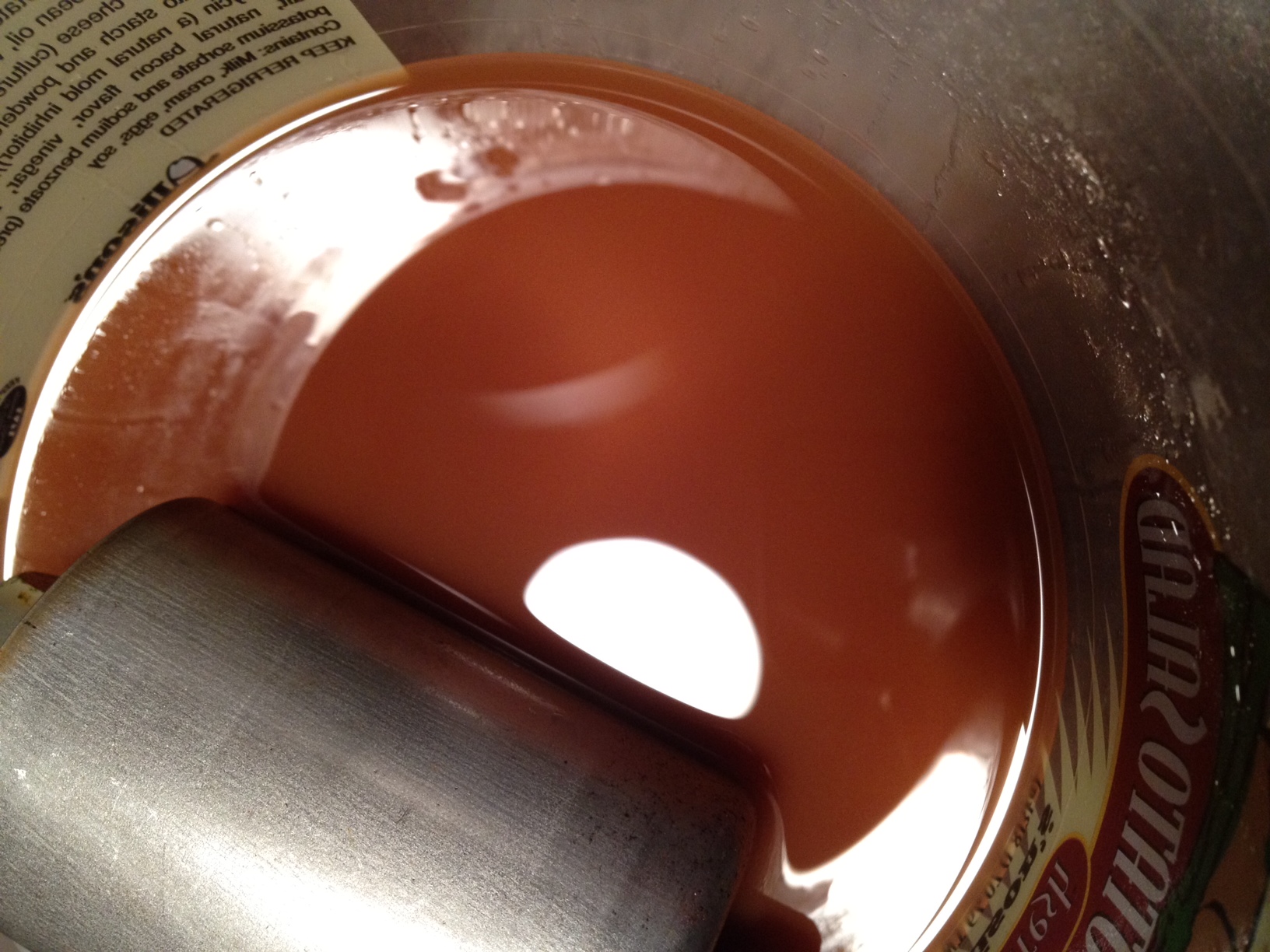

Then, I did a fuel filter replacement. This was probably the most interesting thing I found. It looked like pure mud and silt in coming out of the filter. Literally, take a look at the pictures.

drop the tank and clean it out really good, making sure to blow the lines out relly good.. also pull the injectors out and clean them up with some carb cleaner..
